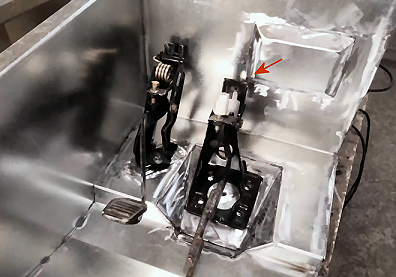

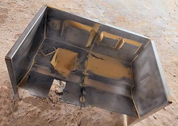

Getting things done in the firewall box mold, the brake booster mount, and the chocolate bars are for both strength and to stop 'tin canning' vibrations.
- 230602 001 brake boosteer mount 001.png (211.47 KiB) Viewed 1985 times

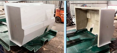

Per Mark BEX ....
The firewall box mold is close, just a few liitle things to do, should have it in the bag by the end of the weekend.
Oh, and: Hmm, shiny!
- 230603 001 firewall box mold 001.png (188.18 KiB) Viewed 1971 times

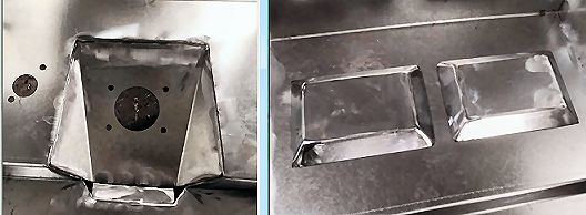

Per Mark BEX ....
Into the final stages of the mold, just about finished.
Setting up the pedals, and I did change their orientation slightly.
I also had to cut a corner off the chocolate bar directly above the brake pedal assembly for bolt clearance, the corner the red arrow is pointing too, but not yet removed in this earlier picture.
- 230605 001 final stages of teh mold 001.png (238.75 KiB) Viewed 1955 times

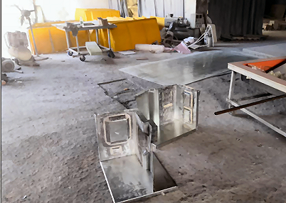

Per Mark BEX ....
Dropped the firewall box molds off at my old fiberglass works today, and to my shock he said he will have one ready tomorrow.
He is notorious for not getting things done quickly, but great trustworthy quality.
The new mob I tried for the floor, well I am a bit disatisfied with their work, it happens, but in the short term, I did figure out the floor using them.
- 230607 001 molds at fiberglass works 001.png (257.45 KiB) Viewed 1940 times

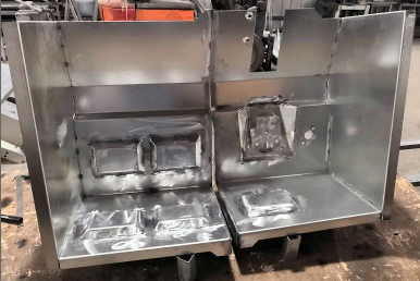

Per Mark BEX ....
My fiberglass guy said there was more prep involved than he thought, so it's now ready to pull a part tomorrow.
- 230609 001 ready to pull a part 001.png (182.32 KiB) Viewed 1924 times

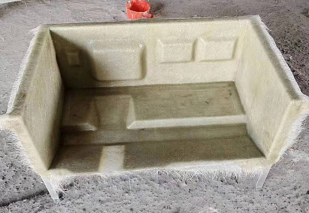

Per Mark BEX ....
My F'glass guy sent me this picture this morning, so I got all excited, jumped in the car, drove over to grab it .... to be disappointed.
I thought the picture was a finished piece, but in fact it was still in the mold drying (it was still tacky) and untrimmed, so will get over there tomorrow morning. It's an hour round trip away.
As usual, his work is excellent, and you're looking at the 'rough' side here ...
- 230610 001 curing 001.png (236.77 KiB) Viewed 1908 times
