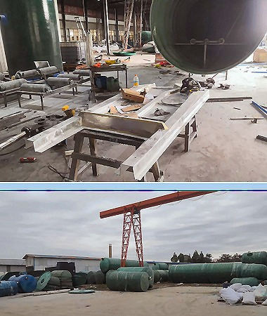

I dropped into the fiberglass company this morning, I wasn't expecting much as Chinese companies are typically slow to get a start on something, but once they do, they are very fast.
They should be finished by week's end, and then needs about 3 days to cure properly, but good news is they are not closing for the holidays, so I should get my first part at the start of next week.
In the meantime I am doing lots in CAD, and it's being productive.
Their main products are large septic tanks, the end caps for the tanks, and sullage tanks are about the same as making my parts.
- 230424 001 under construction 001.png (319.2 KiB) Viewed 1726 times

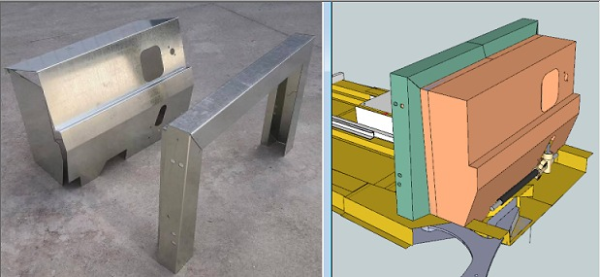

So I got the A pillar 'arch' and the firewall box done today, only 3 pieces needed to make each, simpler, faster, less welding, more accuracy etc. I consider these to be of production design.
Oh, and one big change which I wanted to acomplish, is the steering rack is now on the outside of the firewall, see the CAD drawing, earlier I wasn't sure if I could achieve that until I finalised the floor. It's main feature is it simplifies sealing the firewall box to the outside elements.
Just waiting for the floor now, and that is also a production design, so starting to chip away towards a final, reproducible result.
- 230429 001 A pillar 'arch' and the firewall box 001.png (210.43 KiB) Viewed 1683 times

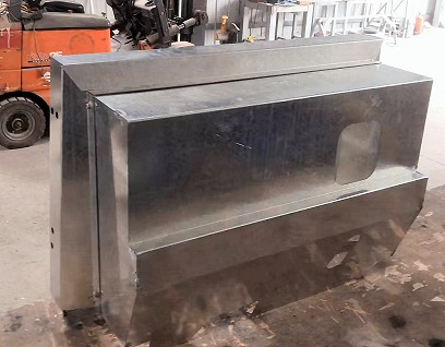

Still waiting for floor progress, so stuck the firewall box and A pillars together in anticipation.
I really want to make the firewall box in fiberglass as well as it helps insulate the passengers from the engine heat, noise and vibration, but I'll make a firm decision when I have the floor.
- 230502 001 firewall box and A pillar 001.png (206.53 KiB) Viewed 1651 times

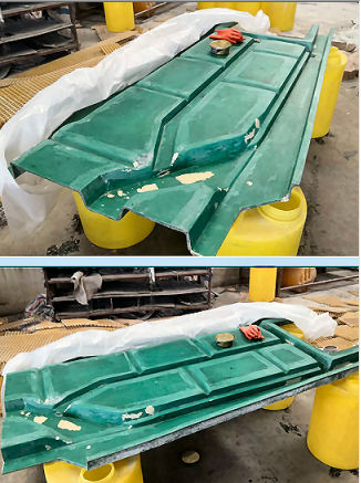

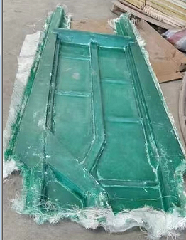

I was at the fiberglass company today, still no floor, but the mold is finished and all waxed up ready to pull a floor from it.
You can see a little bondo where they fixed some blemishes, that's pretty normal.
The mold is 10mm or 3/8" thick.
- 230511 001 Finished Floor Mold 001.jpg (47.27 KiB) Viewed 1561 times
- 230511 001 Finished Floor Mold 002.jpg (17.36 KiB) Viewed 1561 times

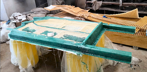

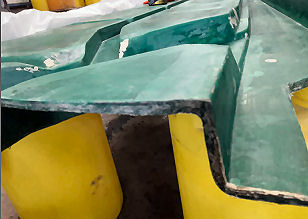

First floor out of the mold, here in all it's glory in a stunning blood red colour.
This is literally the first production part, lets hope there's more soon.
- 230514 001 first floor out of the mold 001.png (197.31 KiB) Viewed 1523 times
