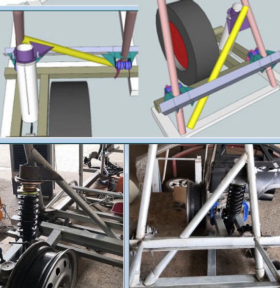

Per Mark BEX :
Designing the rear strut upper mounts, purple, and for those worried about lack of bracing, the yellow tube is the first installment of bracing ..
- 210705 001 rear strut brace 001.jpg (24.3 KiB) Viewed 2326 times

Per Mark BEX :
The laser place didn't work the weekend, so didn't get my rear strut mounting plates until today.
But here it is done, just like the CAD cartoons
I'm close to sitting it on wheels for the first time ....
- 210712 001 swingarm strut 001.jpg (71.11 KiB) Viewed 2292 times

Per Mark BEX :
Sometimes you have to go back a step or 2 ...
Looking at how to mount the rear strut to the swingarm proper, I realised I can make the existing joining brackets as the lower strut mounts as well.
So have to cut the axle off the swingarm, laser cut these new purple brackets, and stick it back together!
I have multiple holes for testing later, so I can change the motion ratio to suit (make the suspension softer or harder).
- 210713 001 lower swingarm strut mount 001.jpg (41.27 KiB) Viewed 2284 times

Per Mark BEX :
Well, that went well.
Lower rear strut swingarm mounting brackets, with adjustment holes, kind of looks like the drawing even .....
- 210713 001 lower swingarm strut mount 001.jpg (41.27 KiB) Viewed 2265 times
- 210715 001 lower swingarm strut mount 001.jpg (36.58 KiB) Viewed 2265 times

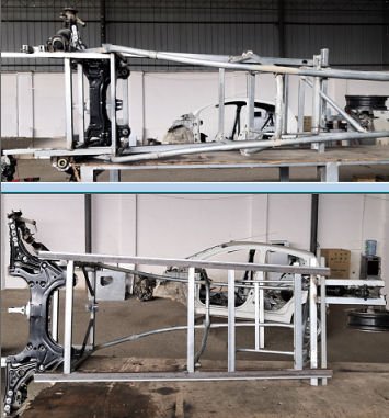

Per Mark BEX :
Laying it over on both sides today, to complete the welding as required, and upside down tomorrow to do all the underneath welds.
You can see the roof taper quite well with these shots.
- 210716 001 flipped for welding 001.jpg (37.68 KiB) Viewed 2257 times

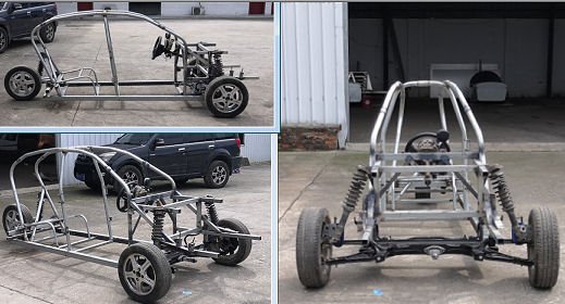

Per Mark BEX :
Sitting on it's 3 feet for the first time ....
short UTube video --- https://www.youtube.com/watch?v=__6-NggQILA
- 210717 001 on its feet for the first time 001.jpg (42.04 KiB) Viewed 2249 times

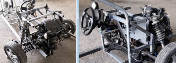

Per Mark BEX :
I popped the engine, temp firewall, pedals and master cylinder back on today to start the long process of getting it drivable.
- 210718 001 motor and some other items reinstalled 001.jpg (41.2 KiB) Viewed 2242 times
