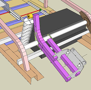

Re: Elio Type Vehicle Resurection --- AKA the BEX
Per Mark BEX ....
My eyes are sore.
I have been in CAD for 2 days straight now, trying to work out the swingarm, must have done a 100 variations on the theme.
Happy now, will go to metal tomorrow, it's simpler, neater looking, lower weight, and now fully adjustable with ease for the rear wheel toe and camber.
My eyes are sore.
- 230303 001 latest swingarm 001.png (158.89 KiB) Viewed 1440 times

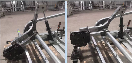

Per Mark BEX ....
I am most pleased with the swingarm, I told ya's I would get it into metal today, it's about 80% done.
Only issues are minor, and more in the process of assembly processes than any design problems.

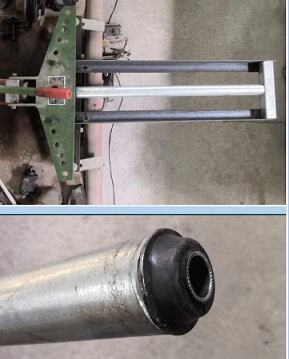

Second Picture : I have made so many special tools over the years, and added another one today, a simple adaption to my pipe bender to press the swingarm bushings into the swingarm tube.
- 230304 001 latest swingarm 001.png (188.62 KiB) Viewed 1431 times
- 230304 002 swingarm bushing press 001.png (157.25 KiB) Viewed 1431 times

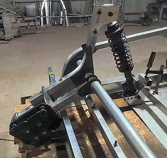

Per Mark BEX ....
Pressed both bushes into the swingarm tube, mounted the swingarm,
Then made some 'J' brackets with pressed in a bush, to bolt to the standard, OEM's strut's lower mounting brackets.
- 230305 001 bushings pressed 001.png (671.41 KiB) Viewed 1414 times

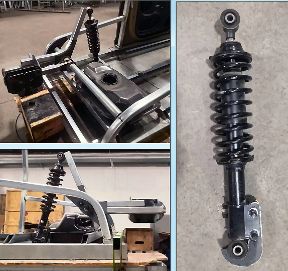

Per Mark BEX ....
Getting the rear suspension sorted out bit by bit ..
What you are looking at in the video below is practical geometry testing, so its all a bit random, will eventually be a neater presentation.
https://www.youtube.com/watch?v=9B-56ZstYXw&t=50s

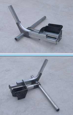

Per Mark BEX ....
More work on the rear suspension, optimising it further.
You can see the lever arm angle has been reduced, and the bracket shortened, the gusset doesn't match now, but that's a 'meh' item.
This will do for road testing for the moment, and still have a few adjustment holes to play with.
- 230308 001 Swingarm Revisions 001.jpg (35.99 KiB) Viewed 1378 times
- 230308 001 Swingarm Revisions 002.jpg (32.88 KiB) Viewed 1378 times
1 x
