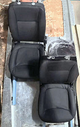

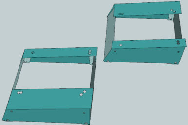

I'm going to bore you with the seats again, 3rd and final 'production worthy' seat podiums finished today.
They are so important to get right, as their positioning determines the final length of the car, by way of the fuel tank position, that determines the rear wheel location.
You can see in the CAD drawing there is multiple locating holes for the seats, that has the front seat straight with the centerline of the car, and the pax seat at 3 degrees inline with the car's taper, you can it see in the picture, and it works out well.
- 230216 001 positioning 001.jpg (25.43 KiB) Viewed 1389 times
- 230216 002 mounts 001.jpg (10.62 KiB) Viewed 1389 times

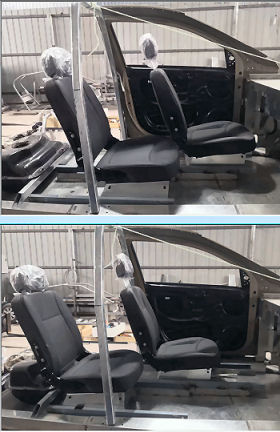

Good news day.
Very happy with the fact that the staggered seats are going to allow the shortening of the wheelbase and likely the whole car, by at least 150mm/6", this is beneficial in every way, especially turning circle, that's obvious, and stability, as the shorter wheelbase allows a lower car (ever seen a limo grounded ..).
I finally got the runners to where I like them, offset and running length, lightly welded them into place, which determines where the fuel tank will go, which determines where the rear wheel goes behind it.
This has also allowed me to realise that for 95% of passengers getting in and, the driver will likely be able to stay in their seat, and just pull themselves up to the steering wheel for a moment while the pax gets in and out.
Good news day.
- 230218 001 seat mocked up 001.png (176.74 KiB) Viewed 1380 times
- 230218 002 too low 001.png (160.4 KiB) Viewed 1380 times

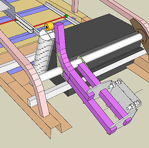

Re: Elio Type Vehicle Resurection --- AKA the BEX
Per Mark BEX ....

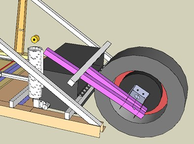

Because I am now slightly wider at the floor, I can make room to be able to move the rear suspension strut forward, and off the rear axle, up next to the fuel tank.
It take no more effort or material to achieve this, but it has real benefits:
It lowers the unsprung weight off the rear tyre, which helps with comfort and less chance of punctures, as the tyre is able to rise at a faster rate.
But importantly, and I have mentioned this many times now, it moves the weight of the strut, which is heavy, forward of the rear wheel, and lower, helping to make a safer, more stable vehicle.
Also it will allow for a larger parcel shelf behind the passenger.

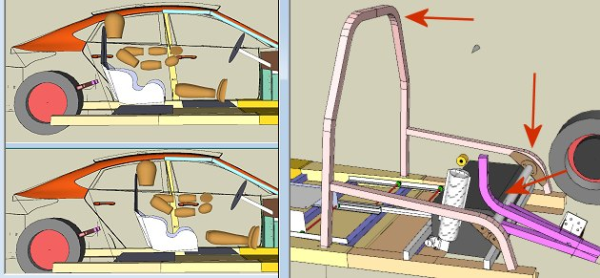

- 230223 001 revised rear suspension 001.png (153.44 KiB) Viewed 1328 times

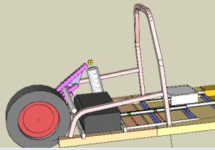

Per Mark BEX .....
It's a bit complicated at the moment, the roll bar (which i am doing new patterns for, pictured), the fuel tank (now temp mounted, picture) and the rear suspension, are all integrated with each other, so you make one, and have to check with the other 2 that they all fit together. But going well otherwise.
I am doing a heck of a lot, for almost zero visual changes, a bit annoying, but that's how it is sometimes.
- 230225 001 revised roll bar 001.png (214.7 KiB) Viewed 1304 times

Things are fitting into place, may look a mess to your eyes, but I see future goodness, with ducks lining up.
Good news: I can almost promise that the pax seat will be able to be reclined back, something Elio could not offer, and that there might be a decent sized rear parcel shelf behind the pax seat now that the suspension is out of the way.
I wasn't keen on a rear parcel shelf before, due to raising and moving the center of gravity rearwards, but this one will be quite low, and further forward than before.
I will keep boring you with stability comments, because it's very important with a 3 wheeler, and it's important to me that I know I have done my best to offer you a 'safe as I can' vehicle.
- 230226 001 revised seating 001.png (200.85 KiB) Viewed 1288 times

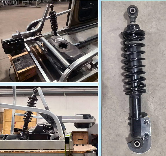

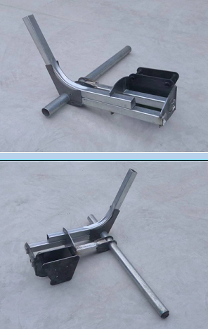

Per Mark BEX ....

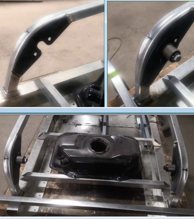

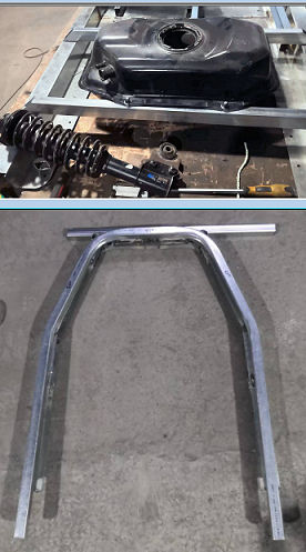

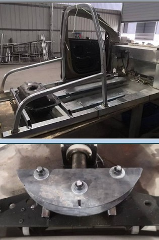

Got the rear stanchions done today, important as they protect the passenger, the fuel tank, and support the rear suspension swingarm.
I am using box tube for the job, and have been annoyed that no one in my town bends square tubing, so the other day I made my own bending die to do it myself, works ok on the heavier tube, quite satisfied.
Trick was to make it in pieces, put the tube in, and clamp it down hard with the 3 bolts to stop the tube spreading while bending it.
- 230227 001 rear protective cage 001.png (219.27 KiB) Viewed 1277 times
- 230227 001 rear protective cage 002.png (80.05 KiB) Viewed 1277 times
0 x

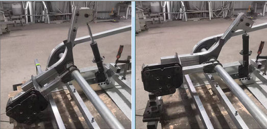

Per Mark BEX ...

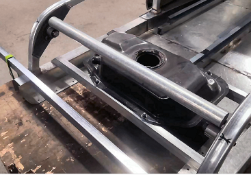

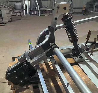

The rear swingarm is going according to plan.
Mounts lightly welded into place.
Bushing mounts bolted on.
Swingarm tube cut to length, but just sitting there in the picture.
Usually I am my own worst critic, but for this design, I will pat myself on the back, simple and effective.
- 230228 001 revised swing arm mount 001.png (262.71 KiB) Viewed 1257 times
- 230228 001 revised swing arm mount 002.png (199.97 KiB) Viewed 1257 times

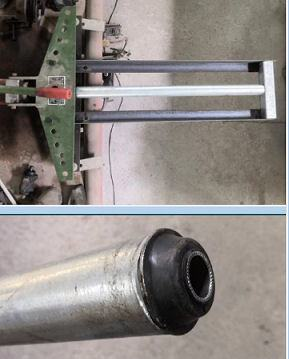

Per Mark BEX ....

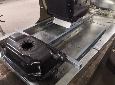

In other news, I keep forgetting to mention yet another advantage to the staggered seat, and that is the passenger is move further forward into an area where the roof is higher, i.e. more headroom.
Just a technical note: The 5 tube bends of the 7 in the picture, red arrows, are all the same degree bend, just a little time saver there, and more KISS.

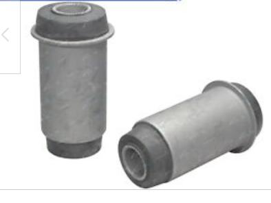

Very happy I found a simple way to use a bush for the swingarm pivots I have been wanting to use, no machining or welding required, and it's the front lower control arm bush from 80s and 90s 85 series Toyota HiLux, found all over the world and plenty in stock everywhere.
It's a great bush for the application, as it's double the width of a typical bush, and very importantly has an 18mm bore for a very strong pivot bolt, rather than a more typical 14mm hole.
- 230301 001 passenger weight forward 001.png (244.05 KiB) Viewed 1240 times
- 230301 002 bushing 001.png (57.79 KiB) Viewed 1240 times
0 x
