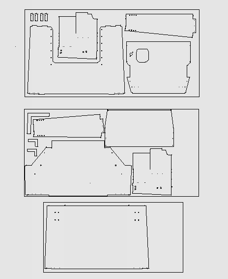

I thought I had lost 2 days CAD work today, had to restart the computer after a freeze, then spent the next hour trying to find my files from the last 2 days, probably 30 hours worth, I was really quite upset, then I finally discovered that I had been working directly from my backup USB, darn it.
But at least I didn't lose the files.
Minimal parts count, which will be lowered further later.
- 230108 001 latest CAD 001.png (14.37 KiB) Viewed 959 times

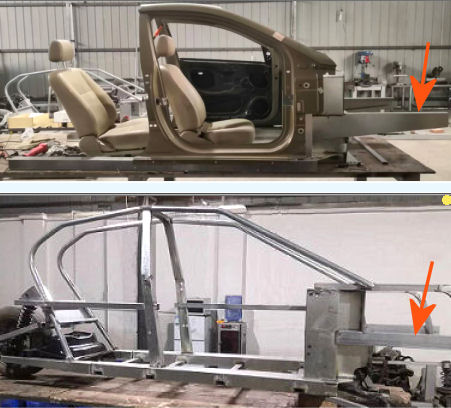

In less than 20 working hours, starting from nothing, I have built this new floor, pillars and firewall chassis, including being slowed by minor mods and stopping to think about things along the way. Very happy about the ease and simplicity of construction.
From nothing meaning, leaving the shop with only my USB, buying steel, taking it to the laser shop, cutting the parts, then to the fold shop, back again and assembling and welding.
One of the most obvious changes is the size of the main engine rails, arrowed and compared to the last one. Main reason is the last one is a purchased rectangle tube, and there is too much variation in them, but also the new one is clearly larger, being double the height at the root, but also it's a laser'd and folded sheet now for consistent accuracy.
And no, it's not a pickup
Next picture is of the sides cut into 2 pieces, I knew i had to, but still grimaced taking a grinder to a brand new panel!
And last picture is the "Secret Squirrel" modifications I am making, the yellow arrow clearly pointing out the changes ..

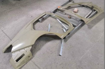

- 230114 001 main rail 001.jpg (43.57 KiB) Viewed 885 times
- 230114 002 cut up 001.jpg (15.1 KiB) Viewed 885 times
