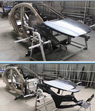

Skyhook​

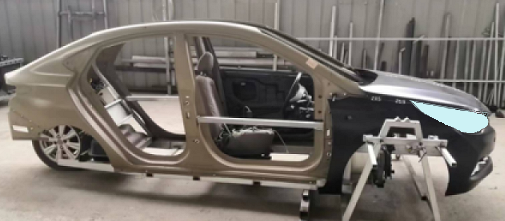

So I got my skyhook together today, quite pleased with it, adjustable on 4 axis, and annoyed it took me a couple of days (casual thinking) to figure out something that turned out so simple.
As you can probably understand, it simply rolls onto the front of the car​

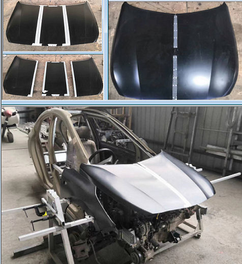

Per Mark BEX ....
Cutting edge tech ...​
I cut out the middle of the hood today, and used a mesh and rivet bandaid to stick it back together.
Wish I had of put the bandaid on first, because about 1 second after I took the lower picture, the left hand hood half fell to the ground causing a slight dent ...
I am playing with positioning of the panels, not set in stone, so don't get excited either way about it, early days yet ...

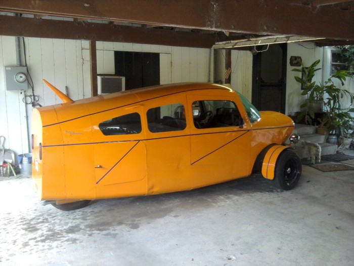

anyoldways, I have designed something based on the VW Beetle, but a LOT weirder. It would start with the floor pan and front suspension from a VW beetle (NOT a Super Beetle with McPherson struts). It would use Honda Valkyrie engine, trans and rear suspension. The body would be from ... no kidding ... a Cessna 310 fuselage, which is 4 feet tall and 4 feet wide, or 1 foot less then a VW beetle in both directions. Just picture VW beetle front fenders on it. Low, lightweight and good aerodynamics are built in! I'm thinking it should be pretty good on gas, if I can keep my foot out of the throttle.
cessna_310a fuse.jpg (66.62 KiB) Viewed 940 times
It's not like something like this hasn't been done. They are known as "reverse trikes", and there are a number of them out there in various forms.

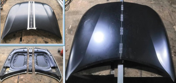

Per Mark BEX ....
I took another 3"+ out of the hood's width, the headlight law has made me refigure how I am approaching this, and happy with the thought process, should be easier and cheaper, just have to wait and see if it works in practice. .

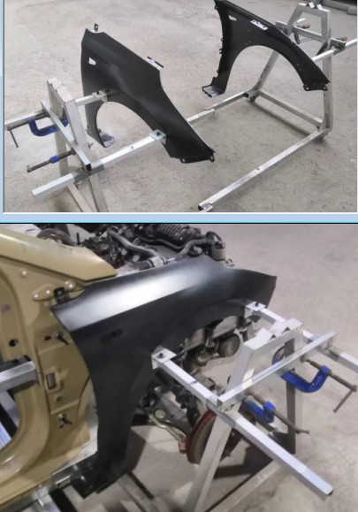

Per Mark BEX .....
My skyhook certainly makes life easier to roll the nose in and out.

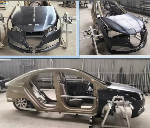

Per Mark BEX ....
Just chipping away bit at a time ...
Finally the group of pictures show more how sleek it is in real life.​
And the single picture shows where the front running light is ..
221211 002 front end status 001.png (369.73 KiB) Viewed 904 times
