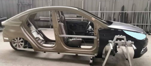

95% there with the new factory folks, for the first time today I actually had almost everything in place and setup, and large workspace with the car finally in it.
Came home tonight and spotted this mannequin in the rubbish, so I grabbed it and might try to make it into a 'sitting in car' form, which may be handy as I'm setting up seating positions etc.
Also I will not be the only dummy in the shop now, and I will have someone to talk to
- 1b.png (192.95 KiB) Viewed 1126 times

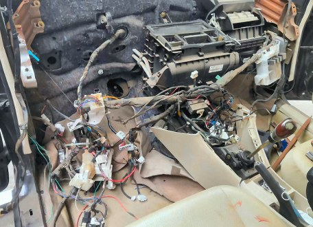

A Dog's Breakfast ..
Build a car they said, it will be fun they said ...
Removing and tagging the wiring loom out of the donor car, in Australia we call a mess like this a "Dog's Breakfast" ...
Thank goodness I am an expert at pulling things apart.
- 221129 001 donor car wiring loom 001.png (327.72 KiB) Viewed 1115 times

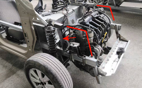

Re: Elio Type Vehicle Resurection --- AKA the BEX
Per Mark BEX ...
Don't be nosey.
I dislike going backwards, but the upper front rails had to come off, red lines where they were, and bracing substituted, red arrow. I will add a bit of bracing underneath, strength isn't an issue.
The issue is the massive headlights, I simply didn't think they would be so darn big.
I'm figuring how am I going to do the front bodywork/nose. There's nothing to hang it off, it's a 'Catch 22' situation where I need the nose to make brackets, and I need brackets to make the nose ...
I think I'm going to have to build the nose fixed onto an exo frame, on a trolley on wheels, so I can wheel it on and off the front of the frame into place, while I decide it's shape and size, as well as making mounting brackets.

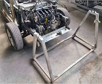

This is the idea I mentioned yesterday, a trolley on wheels that will hold the nose with an exo frame (external frame), then I can wheel it in and out as I need while sizing the assembly, and designing mountings for it.
This trolley is a fraction too small to do it.

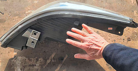

Below is a picture of the headlight and my hand to enlighten you of how large they are ...
- 221204 001 trolley on wheels 001.jpg (30.08 KiB) Viewed 1038 times

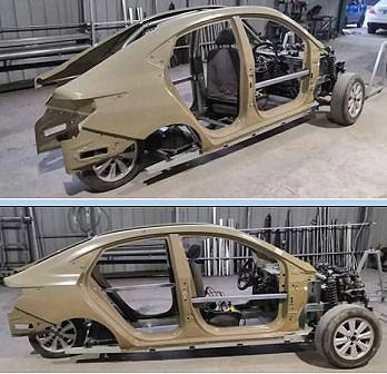

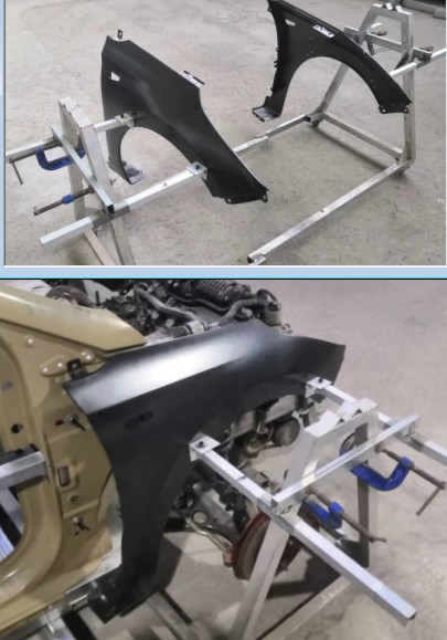

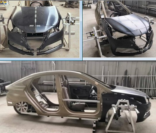

Today the job was to properly affix the sides to the frame so I can build the nose of course. I had to cut sections out of the sides to fit over the side impact bars, I always grimace when i have to cut brand new parts, going to be worse when I have to cut chunks out of the doors to fit. ...
The trolley you saw yesterday that i said was a bit too narrow, well I cut it and widened it to suit, job done, but still trying to figure how to attach the gibsons, I mean the fenders to it so it's adjustable in all directions.
The car looks really sleek in the flesh, the pictures really don't do it justice, going to be a good looking thing i think ....
Sleek.
- 221205 001 fitting the body 001.png (214.05 KiB) Viewed 1029 times
