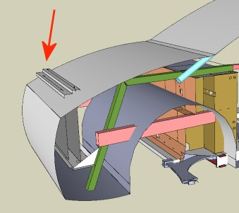

I will have to buy some front panels and start the nose bodywork, as the CAD is suggesting that the radiator/condenser are too tall where they are located.

Re: Elio Type Vehicle Resurection --- AKA the BEX
Not really surprised, after seeing the initial picture of that radiator. i know Mark will make it right though.
1 x
Just add a scoop
1 x

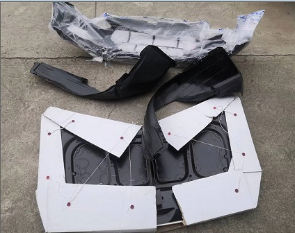

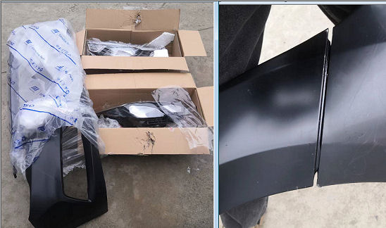

Per Mark BEX ....
Parts arrived, lets see:
1 x hood, check.
1 x front bumper bar, check.
Left and right inner fender liners, check.
1 x hood, check.
Per Mark BEX ....
I ordered left and right fenders, and they sent me left and right plastic inner fender liners.
Fenders are now on their way.

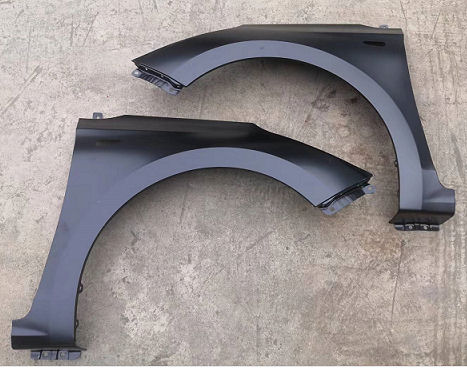

Per Mark BEX ....
That's a bit better, real steel fenders ...
But, I have to order the headlights now, as a quick look tells me I might have clearance issues behind where the headlights will sit. Clearly there is a couple of other clearance issues, none of them a big problem.
