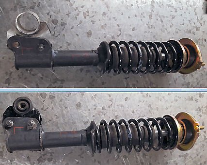

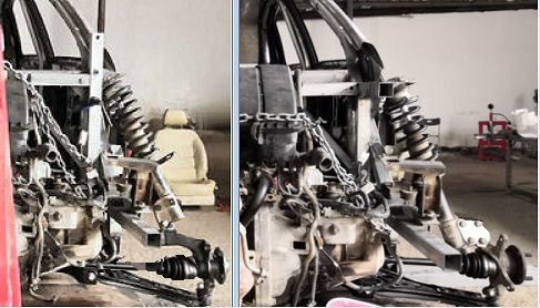

I was in the factory today, working very slowly being aware of my back, just doing some welding to the new strut top mounts, measuring and other items. I could actually bolt wheels on the front now when need to be to test, which will be soon.
First I need to sort out a RH CV shaft, that's the next job, and then get the rear swingarm mounted.
I imagine I will sit it on 3 wheels within 1 to 2 weeks.
Maybe hard to see in this comparison picture, but the front suspension struts are much lower, and more tucked in. If unsure, just look at how close the bottom of the strut is to the CV shaft in the new (right side) picture, compared to the old (left side) picture ...

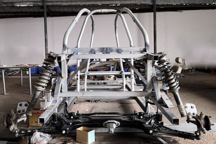

Re: Elio Type Vehicle Resurection --- AKA the BEX
Per Mark BEX :
I did what I do best today, took all her clothes off.
I need to access various areas of the frame to finish the welding, but also importantly I need to access the rear to start attaching the rear swing-arm, hopefully start on both tomorrow.

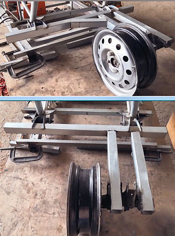

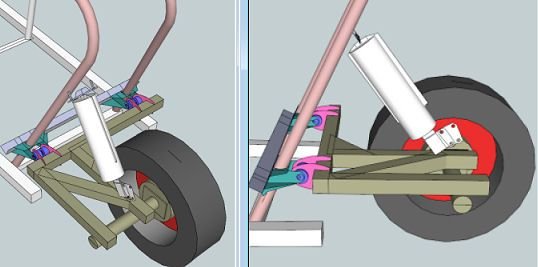

My current delay is that when I went to make up the rear swingarm bushes, just looking at it told me that there really wasn't enough bush area, so I decided to double up the bushes each side .... Picture 1
I can use most of the laser cut brackets still, just in a slightly different arrangement, and I'm just waiting for the other 2 bushes I ordered to arrive.
Hope to end up something like this, note no bracing depicted .... Picture 2

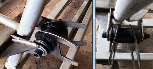

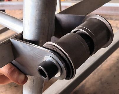

Getting the swingarm brackets and bushes sorted out.
Looks a bit rough because I changed it to double bushes, and just modifying the brackets I already have, rather than making new ones at the moment.
This is the left side only, still waiting for the other side's 2 bushes to arrive to complete it.
The forks are where the swingarm gets welded into.
doubling the brushes sure makes it look much stronger ...

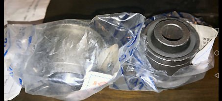

Finally, my other 2 bushes arrived today, won't deal with them again.
This has stalled me because too many things are related to the installation of them, and I have been concerned to move forward until I have the rear swingarm in place, so I can put the wheels on, and setup the ride height.

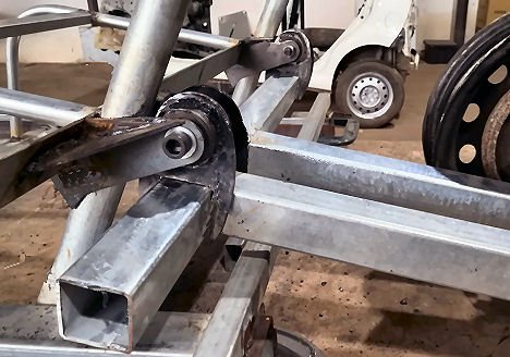

Per Mark BEX :
Ahh finally moving forward again.
The swingarm is in, lots of cleaning up and bracing yet, but heading in the right direction ..

Per Mark BEX :
Last 2 days doing some personal stuff, but back to it today, even though it was around 110 in the factory ...
Picture 1 -- Turned the swingarm pivot mounts 90 degrees, this has shortened the wheelbase by 3", and placed some weight lower, which is always a good thing.
Picture 2 -- And made a pivot mount with bush to make life easy to attach it to the swingarm.
