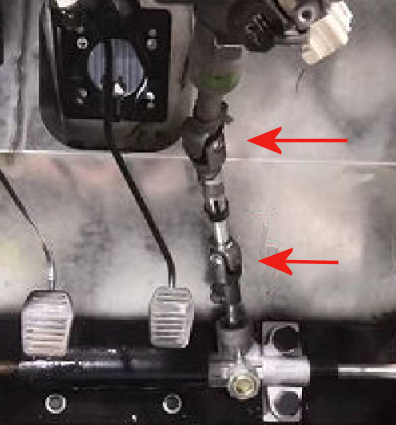

when asked : "Speaking of steering columns, I am curious if there will be a "rag joint" in the steering column??"
Mark BEX responded : " No, you can see quite clearly in a number of pictures, 2 x universal joints .."
221021 001 steering column 001.png (184.92 KiB) Viewed 823 times

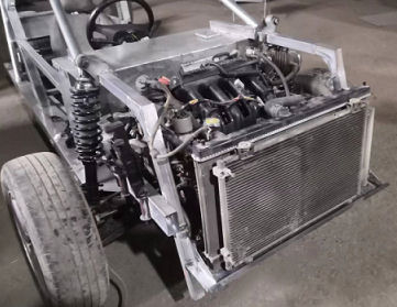

Per Mark BEX ....
As you see by the shadows of the factory lights, working late into the night developing the very front structure to support the radiator and air conditioner condenser ..
221026 001 motor mounted 001.png (238.64 KiB) Viewed 770 times
1 x
Posts: 10828
Re: Elio Type Vehicle Resurection --- AKA the BEX
Post by markiver54 » Wed Oct 26, 2022 10:41 pm
Wow, that's a huge radiator.
0 x
Posts: 20095
Post by JEBar » Wed Oct 26, 2022 10:57 pm
my thought exactly .... I've asked Mark about it and will post what he says
1 x
Posts: 20095
Post by JEBar » Thu Oct 27, 2022 5:49 pm
In response to me commenting to him about the large the radiator ....
Mark BEX stated,
"Unusually so, it's because it's only 2 rows, i.e. very thin. I would have prefered a little thicker and more offset to the left for weight bias, but not going to argue with a setup that a few million cars successfully driving around.
Leaves room for a battery low and left, which is good.​"
1 x

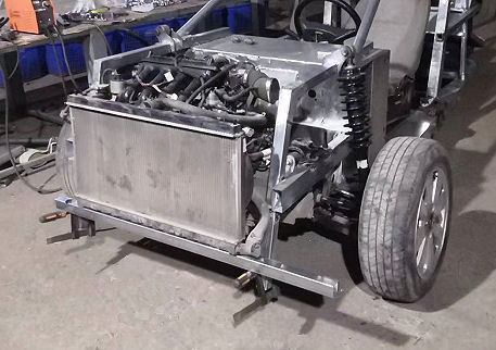

Radiator and air con condenser lower frame mount is done, lot of work in it, Now to make a simple top bracket/brace for them both.​
221102 001 Radiator air con condenser lower frame mount 001.png (158.82 KiB) Viewed 677 times
