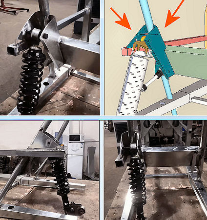

Re: Elio Type Vehicle Resurection --- AKA the BEX
Per Mark BEX ....
Working out the rear suspension mounting, looks like it will work out.
Rear anti-intrusion bar from the B pillar to the C pillar, is welded in and is part of the suspension mounting
- 220922 001 modified rear suspension 001.png (246.92 KiB) Viewed 1238 times

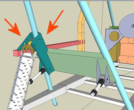

Per Mark BEX ....
Well hopefully the rear suspension mount looks something like the CAD drawing ...
- 220923 001 rear suspension mount 001.png (371.96 KiB) Viewed 1230 times

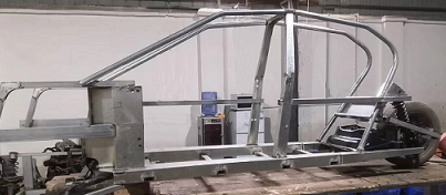

Per Mark BEX
A rear wheel and the rear suspension are on, as well as the chassis set at ride height so I can start figuring out some associated things such as the front suspension, and exact fuel tank mountings ...
- 1b.png (136.04 KiB) Viewed 1210 times
1 x

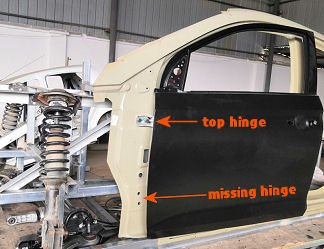

when asked, how do you attach the frame/roll bar to the outer shell ???
Mark BEX responded :
The primary attachment for the sides, is the 4 x door hinges each side (8 bolts), on the A and B pillars.
The sides are sandwiched by the hinges. You can see it clearly here on the 2nd build, just the one top hinge ...
There will be other attachment points, sills, C pillar etc.
- 220926 002 shell attachment 001.jpeg (23.46 KiB) Viewed 1204 times
