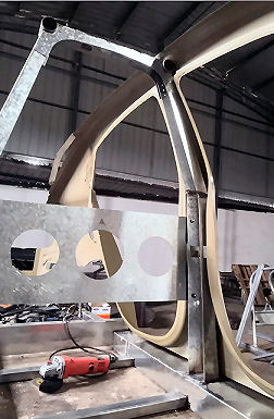

Per Mark BEX .....
Not the best picture sorry, but the B pillar is about perfect, bit of a hassle, but worth the end result, and production slated.
The plate with the big holes is just an alignment jig to square it all up.
That's 'A' and 'B' pillars set in stone, now onto 'C' ...

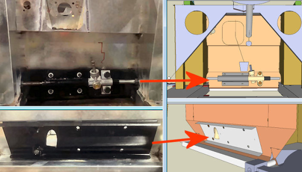

I want to do the rollbars, but that entails sealing down the dash panel making access to the footwell a little awkward, so instead today I finished mounting the steering rack proper.
I laser cut and folded some new mounts, and welded them for the left side of the rack mount, you can see it's locked down with 4 bolts now rather than 2,
... and I laser'd and folded a strengthening plate on the outside of the firewall. Simply a flat plate with 2 x 90 degree folds for strength.
Bit hard to see in the pictures as I painted it all to protect the large mating surfaces from rust, so the CAD drawings are included to explain it.

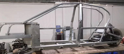

Re: Elio Type Vehicle Resurection --- AKA the BEX
Per Mark BEX ....
Good day today, got a bit done:
Dash top and facia fitted and the footwell box fully welded together
Obviously the front roll bars are sitting in place,
The front suspension upper mounting rail also in place
Right hand intrusion bar welded in,
The clutch and brake pedals boxes sitting in place.
Hope things keep going this smoothly

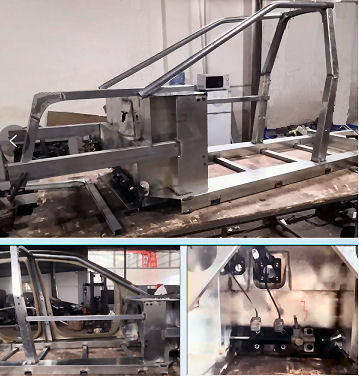

- 220917 001 revised assembly 001.png (241.36 KiB) Viewed 1000 times

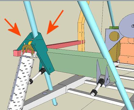

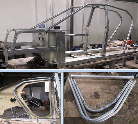

Per Mark BEX ....

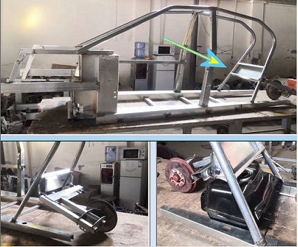

I fussed around a bit thinking how was I going to get the front rollbar legs in the right position, and mirrored equally left to right, when I discovered that the outside of the bend is directly vertically inline with the inner edge of the main rails, only needing to hold a plumb bob to line them up, bit of win there, checked the CAD drawing, and sure enough, that's how it is there as well - see double red arrow ...
After getting the front rollbar legs positioned and welded, moved on to the rear rollbar legs.
Having a bit of a fight with the fuel tank for space, but I have a plan .
Per Mark BEX ....
Changed the design of the rear rollbar leg a little from yesterday, made a 'master pattern', bent up 2 more, and fitted them up.
Next is the rear bulkhead to complete the rollbar, and that the rear swingarm pivots from
- 220919 001 rollbar redesign 001.png (356.4 KiB) Viewed 985 times

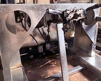

The laser shop had issues today, so waiting for my rear bulkhead to be cut, tomorrow now, so in the meantime started on mounting the steering column and shaft.

- Location: central NC
Per Mark BEX ....

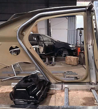

The rear bulkhead just fell into place, close to perfect, and now is fully welded in, and the swingarm loosely hanging off it.
.. as well as checking the fuel tank for clearances, tight but manageable.
- 220921 001 rear assembled 001.png (278.88 KiB) Viewed 957 times
