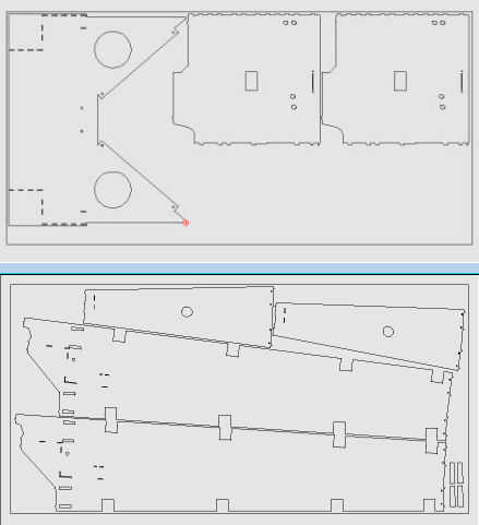

Per Mark BEX ....

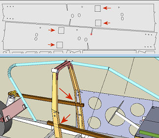

Another unexpected nice surprised today, like the main rails, the A-pillar and dash/dashtop cnc laser files also fit onto the one 4 x 8' sheet, I truly wasn't expecting them to, and as you can see, a tight squeeze.
Also done (below) it is the main rails cnc laser file.
- 220904 001 A-pillar and dash 001.png (72.29 KiB) Viewed 756 times

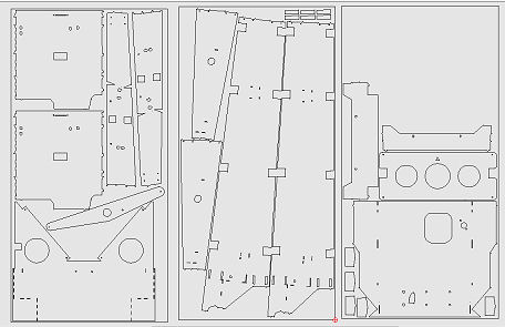

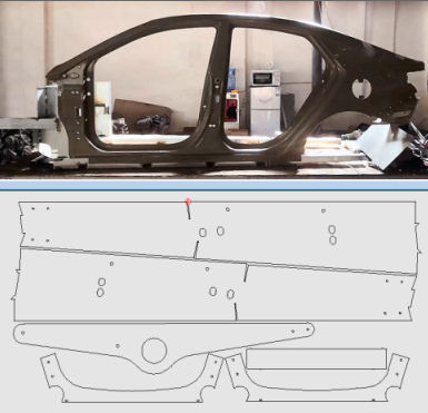

Per Mark BEX ....
Finally have the laser files ready for what I need.
There are 3 more parts to go, that will just fill that upper right hand corner, but I need to assemble the bulk of the chassis first before I can finish those 3 parts (rear bulkhead, center roof crossmember and swingarm subframe).
It's 4am, and I'm going to bed
- 220905 001 most of chassis 001.png (81.21 KiB) Viewed 745 times

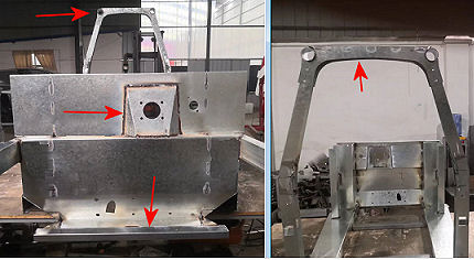

Re: Elio Type Vehicle Resurection --- AKA the BEX
er Mark BEX ....
Yay, most parts are done, and most fit like a glove.
Some jiggling required to get some of the tabs in, but clearly working as intended!
I give myself a B+ because one of the B Pillars I bent the wrong way, now I have 2 x right hand B Pillars, idiot ...
I had to run back to the laser shop and get another B Pillar cut, will fold it tomorrow, hopefully the right way, well the left way actually.
It's so nice I might have to pay a pro-welder to join it together rather than my ugly excuse for welding.
- 220905 001 most of chassis 002.png (248.8 KiB) Viewed 723 times

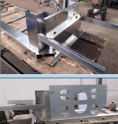

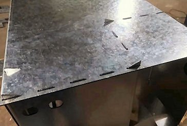

Per Mark BEX ...

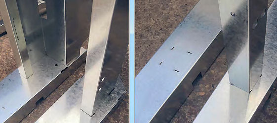

YES! Oh boy, am I happy.
It ticks all the boxes, it just falls together, it just works, it just does, and you're looking at just 6 pieces to create this assembly
I had to take 7 steps backwards to make this very large leap forward, completely worth it!
You can see the tabs sticking through the slots here .. the shark fins are the folding points.
- 220907 001 new firewall assembly 001.jpg (35.84 KiB) Viewed 723 times
- 220907 001 new firewall assembly 002.jpg (18.91 KiB) Viewed 723 times

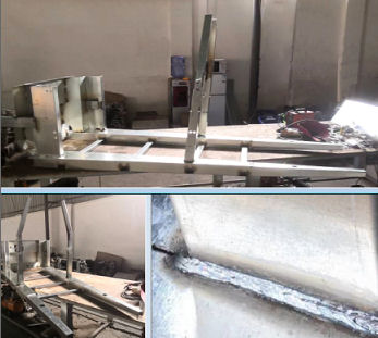

Per Mark BEX ....

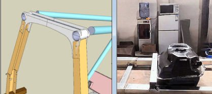

Going together smoothly, added all the floor cross-members and the main front rails.
Did most of the welding myself, as my welding guy was busy and I didn't want to wait 2 days for him, bit ugly but passable, and most are on the inside so you can't see them anyway
Got my template set up for the B-Pillars as you see in the lower picture, so have a look at that tomorrow.
The A-Pillars had 7 tabs on the bottom and 12 on top, I found I only really need 3 on the bottom and only 2 on top, once again CAD computer Vs 'real world', and real world wins.
Got to paint my bench i think, looks ugly in the pictures.
- 220908 001 template set up 001.png (243.69 KiB) Viewed 709 times

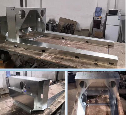

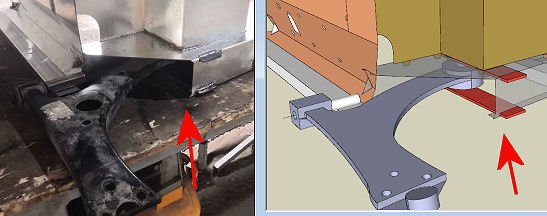

Per Mark BEX ....
Moving along, lots of welding today, B-Pillars are on, and so are the rear main chassis rails.
Some of my welds aren't too bad, but I'm not going to show all of them, ha! Don't worry, I will never be 'the welder' on production.
Again the CAD computer was wrong Vs real life, the B-Pillars were 16mm or 5/8ths" out, but it's not a problem because I know why, and my real life template, see picture yesterday, did the job of placing them where they belong.
Obviously rollcage is next big item.
- 220909 001 new firewall assembly 001.png (172.14 KiB) Viewed 688 times
