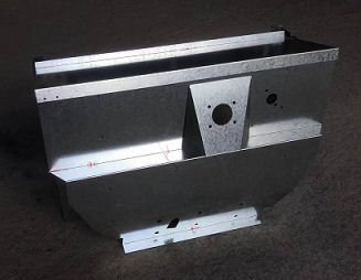

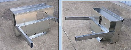

I had to go back to the fold shop this morning and adjust my silly mistake yesterday, luckily it was nothing more than simply add more bend to 2 underbent bends, and it cost me 3 ice creams for the adjustment.
Just loosely sitting on the floor to give one an idea of what it is, very happy the way it's going, and very happy it's all cut from just the one sheet (1M x 2M or 4' x 8'), and 13 of the 16 bends are at 90 degrees.
Not sure what happened with this picture, but how 'Arty' is it!
Also hottest day of the year so far today, well over 100, 3 hours in the factory and I went home, many shops were closed in the streets as well
- 220812 001 Firewall 24 001.jpg (22.31 KiB) Viewed 943 times
- 220812 001 Firewall 25 001.jpg (14.03 KiB) Viewed 943 times

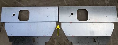

Ack, I made a mistake, such small mistake but made the firewall unusable.
The issue is my CAD drawing parts have zero thickness and I simply calculate in my brain where the thickness will make the difference, easy enough, but I made the mistake of calculating the 2mm/0.020" thickness on the wrong side of the bend, which made a 4mm/0.040" difference, the difference can be seen at the arrow.
So lasered and bent a new firewall this morning, but have to be a little careful with the shops I use, they are also dying from the heat, and it wasn't 100% happy faces when I roll up and they have to walk away from their giant fans (laser shop) or their air conditioned office (fold shop) ... don't want to burn my bridges, these people are critical to me at the moment. They did appreciate the ice creams I bought them though
Further good news is though it's still 100 degrees, you can feel the humidity starting to drop the last few days, as it should be in the middle of August.
- 220814 001 revised firewall 001.jpg (11.74 KiB) Viewed 928 times

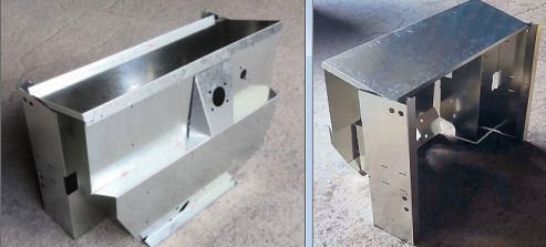

I got some hours in today because the humidy is certainly dropping, despite the 102 degrees it peaked at.
I tacked the firewall assembly together, and quite proud of how it's turning out.
It's a hybrid tube/monocoque setup, that uses the advantages of both, without incurring the million dollar costs of stamping dies, that you would have to pay for in the end price. Instead simply creating the shapes from 2 dimensional folds, and tubing where ultimate strength is needed.
I now find I need to make some templates for aligning, so at home in air con doing that now
- 220822 001 firewall 27 001.jpg (23.57 KiB) Viewed 865 times
- 220822 001 firewall 28 001.jpg (20.03 KiB) Viewed 865 times

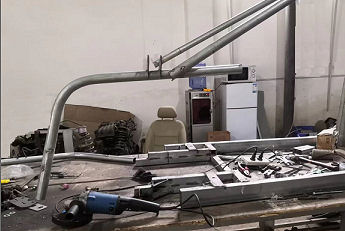

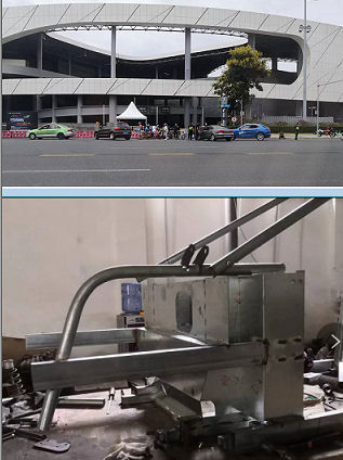

Today I decided to go to the Chengdu Car Show, one of the biggest in Asia. to see if I can sniff out any interested partners or suppliers. Last year they had no minor players, accessories or aftermarket stuff at all, I was a bit annoyed about that, and was hoping they have them this year.
Akk! Chengdu Car Show closed to to local Covid cases, 4 hour round trip for nothing. There's the entrance with security turning people away. Don't they know who I am!!
So back to the factory for a few hours to start fitting up the new firewall assembly, and a stunning idea hit me of how to simplify literally everything, simpler, faster and cheaper, and it's not even red! - looking at it in CAD now

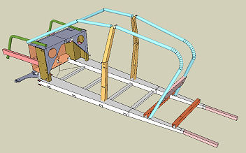

After 3.5 days (long days) in CAD, it's about done, it's exactly the same chassis, I have only changed every single part!
A LOT of detail that you can't see has gone into this one, and I'm genuinely excited this week to stick together what I believe is the final prototype chassis, after simplifying, optimising, and correcting everything i learned on the previous builds, very confident.

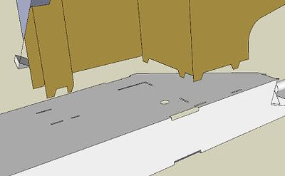

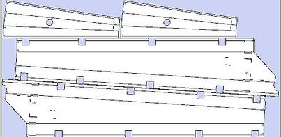

What it offers is a wide flat surface that locating slot holes can be laser cut into, that the major component's tabs will slot into and be positively located, jigless, then welded
Though I hadn't planned it, the main chassis rails fit onto just the one 4' x 8' sheet. These little wins always help.
