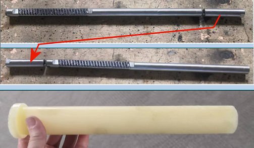

- JEBar
- Town Marshal / Deputy Admin
- Posts: 20094
- Location: central NC
Re: Elio Type Vehicle Resurection --- AKA the BEX
Per Mark BEX ....
My lathe guy did my steering rack things today.
First is to take 100mm/4" off one end, and add it to the other end.
Second is to turn my nylon bushes, both simple procedures.
Though the rack isn't stock 'off the shelf', due to the central steering position, it is built from a stock 'off the shelf rack', merely modifying it, and the addition of a nylon bush.
Point is, it is not a specialised bespoke built item, and any small workshop with a lathe can achieve the same modifications very easily using the off the shelf rack, not that I expect any significant rack wear in it's lifetime on such a light vehicle with no power steering.
- 220726 001 steering rack 1 001.jpg (34.92 KiB) Viewed 944 times
0 x

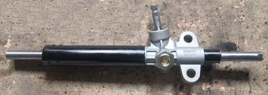

- JEBar
- Posts: 20094
Per Mark BEX ....
My steering rack is looking like a manufacturer's genuine part
- 220727 001 new steering rack 001.png (158.7 KiB) Viewed 931 times

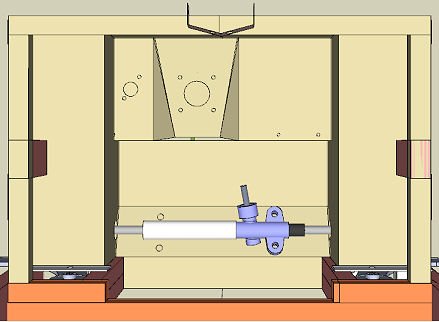

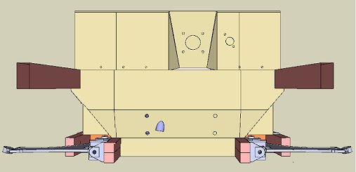

- JEBar
- Posts: 20094
Per Mark BEX ....
I think the new "Office" will work out, some final measuring tomorrow, and then to laser it 1f642.png
Oh, and if it works out, I have lowered the top of the dash by another 1.5" again, over 3" since doing this version. Should help with forward vision considerably.
- 220729 001 Office 2 001.jpg (17.08 KiB) Viewed 914 times
- 220729 001 Office 1 001.jpg (23.31 KiB) Viewed 914 times

- JEBar
- Posts: 20094
in reference to pictures in post above :
Per Mark BEX ....
The lower firewall section was lasered and folded today, after a small mod fits like a charm.
I never fully trust CAD, the small mod required was something that you just don't see on the computer.
Sorry I left my phone at home today, so no pictures. Do you know how I survived the whole day without a phone? - well if you have to ask that, we probably can't be friends .....
Per Mark BEX ....
