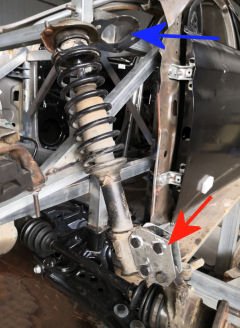

Per Mark BEX

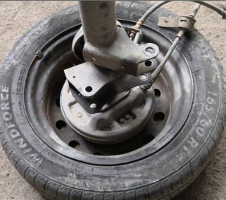

Today's task was assembling and installing the left CV shaft, steering knuckle etc and making some test templates to position the strut, red arrows. I am happy that the strut is not just lower, but further inside the bodywork than previously.
You can see the old strut top mount, blue arrow, and that the new position is no where near it, include that the strut top will need to be some 50mm/2" lower than that when the spring compresses under car's weight .... see picture 1
For the technical minded, I already had a little too much caster for my liking, and the new packaging has increased the caster beyond reasonable. But if I move the strut top in front of the frame vertical tube, green arrow, left picture, there is too little caster. So there was no choice but to remove the vertical tube, replace it with a horizontal tube, green arrow right picture, and start developing the new strut top mounts from there, with the correct amount of caster ... see picture 2

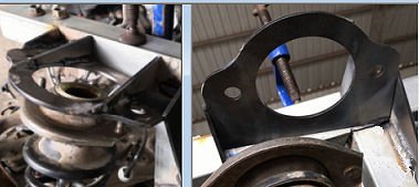

Got my laser cut strut top mounts back today, very happy to have a long, flat edge to work with, makes life easy. As you can see, the edge lines up with the vertical frame member, so again ease of design and implementation is at hand.
Removed the rear axle beam, 5 minutes later it was cut up, and now designing around it to make the rear wheel swingarm.
Had one of those bad hand days, skinned knuckles, numbers of cuts and scratches, worst of all a squashed thumb, right on the nail, some days are like that. I had 2 friends there at the time, Margaret and Tina, they felt really bad that I was in pain, but I told them: "Don't cry for me, Marge and Tina" .....

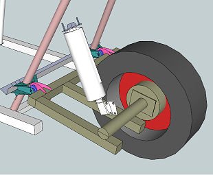

This is roughly what the rear end looks like, a bit blocky looking in this 3D though.
I don't need "Ohh, pretty!" at this stage, so bear it
It will be pivoting on the rear roll cage legs, pink here.

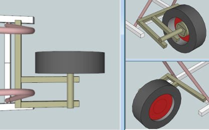

I spent a surprising amount of hours today in CAD getting a bracket/mounting setup for the rear swingarm that I was happy with. Took the file to the laser shop, and their computer was down, so hopefully tomorrow they will be cut.
Note the front of the swingarm is very wide, this is to stop it coming forward into the passenger compartment in the event of a vehicle hitting it up the rear. I will try to design it so the wheel goes under and lifts the BEX up the taking impact energy away.
The rear suspension strut should be something like this:

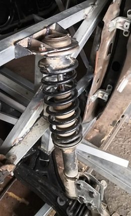

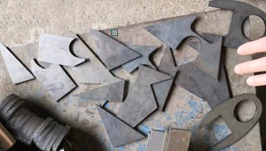

Today I got the laser parts for the rear swingarm mounts and did the front strut top mounts.
The strut mounts are finished, but able to be moved if need be after I check ride height later.
