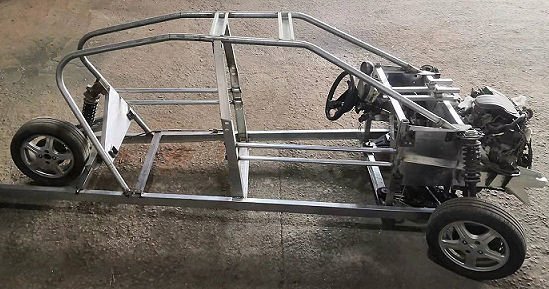

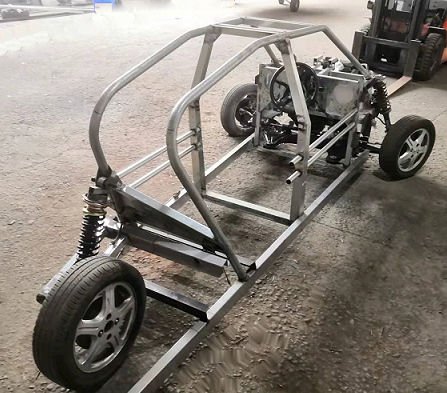

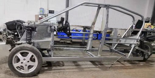

Finally on it's wheels for real, with steering and brakes.
More work to be done, I see it's too low at the front, at least by 1" or more, easy fix as I had planned ahead for it, and I have to make the brackets proper for the suspension to steering knuckle joints.
Good news is the front spring rates feel about right, no reason they shouldn't be close considering the similar weight at the front of the donor.
The rear spring, which is the same as the front, I'm not sure yet until I can get to having a full tank of fuel and a person's weight in the back.
Of course will be great if all 3 spring/damper units are straight "off the shelf" and identical.

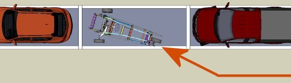

in a conversation about today's rapidly rising fuel prices, Mark commented :
I think gasoline prices make a difference, but I don't think as much difference as many might think, although the $7 or $8 I predict it will at least peak at, will get some people considering a change.
I think the bigger difference is that it forces people to at least consider and try a smaller car, then they realise how practical a smaller car is, the convenience and ease of driving it around town, parking. more garage space at home, etc.and then they don't go back to a larger vehicle.
With a BEX type vehicle, even more advantages like driving forward into a car park in one movement.
- 220308 001 park one move 001.jpg (17.56 KiB) Viewed 1119 times
0 x

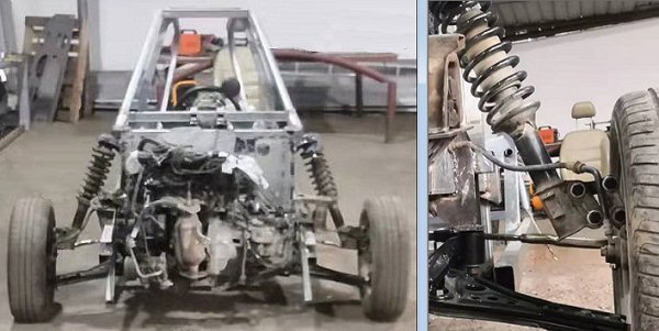

Per Mark BEX ....

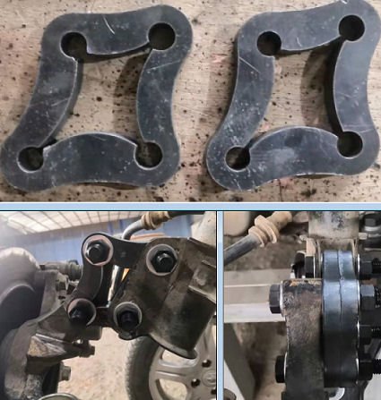

The steering knuckles to suspension strut adapters worked out just great, bit scary when things work first time!
Ride height has been adjusted, couldn't be simpler, and now is sitting at 180mm or 7", but when radiator, A/C condenser, battery, wiring, washer bottle, bodywork and driver, etc, are added, should be down to 5", easy to adjust if need.
Notice rather than 4 separate holes, it's all one laser cut. They are 1/2" thick each, so no question of strength.
- 220309 001 ride hite 001.jpg (45.66 KiB) Viewed 1104 times
- 220309 001 ride hite 002.jpg (47.5 KiB) Viewed 1104 times
- 220309 001 ride hite 003.jpg (31.55 KiB) Viewed 1104 times
0 x

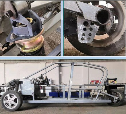

I finished off the rear suspension top mount today, I've actually had the parts for a few months, but had to do the front first.
You can see it here, and the adjustments I had already for both height and spring stiffness (through ratio rate).
Now it's so high it could be on off road vehicle

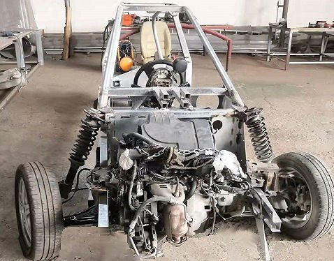

Today bolted the engine, in along with fitting the CV driveshafts .

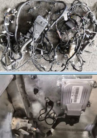

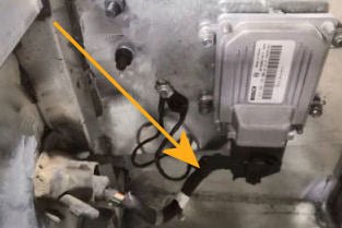

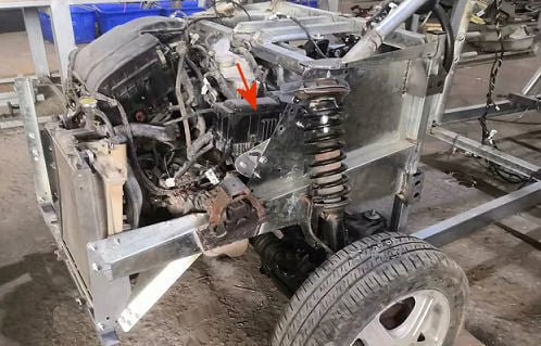

Ughhh, my least favorite area of any vehicle, wiring.
Have the engine computer mounted and plugged in, lower picture.
- 220315 001 wire 1 001.jpg (41.06 KiB) Viewed 1031 times
0 x

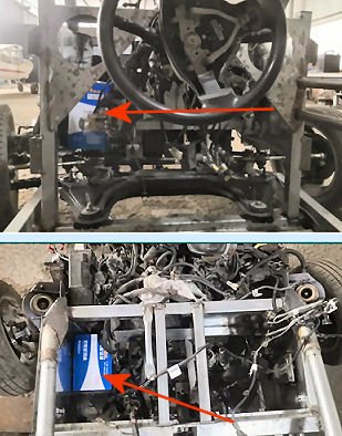

Per Mark BEX .....

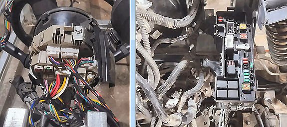

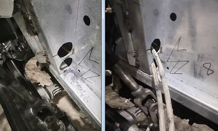

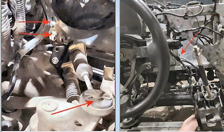

Well most of the wiring loom is plugged in for the engine side of it, still some to go, but I have run across an annoying issue: The wires are too short because I have moved the steering wheel over some 3" or 4" relative to where it and the fuse box were in the 2 seat donor car.
The are some 15 connecting plugs that go into the back of the instrument panel, pictured left, mounted on the steering column, so I ain't changing them! I have to get creative with the mounting of the fuse box, pictured right, to make up some of the length deficit, and hopefully the only issue later will be that the stock wiring loom wires are too short to reach the headlights, shouldn't be hard to fix that, or you lot can just drive only in the daytime and save me the bother.
- 220316 001 wire 2 001.jpg (61.74 KiB) Viewed 994 times
