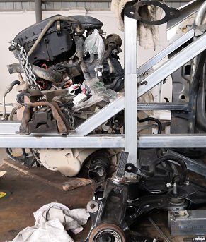

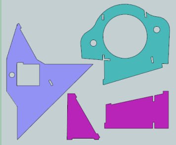

Re: Elio Type Vehicle Resurection --- AKA the BEX

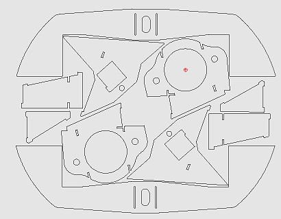

Per Mark Bex :
Getting through the front chassis frame and strut mounts a bit at a time.... Don't worry that it's a but ugly and messy at the moment, lots will be trimmed back, some lasered plates rather than tubes, and some removed later.... I have to use some bolts at the moment because I can't know at the moment how the engine and driveline weight will ultimately affect the ground clearance, so may have to move the strut mounts up or down later accordingly. I spent time today designing the upper strut mounts, worked them out, and ready for a first run as soon as they are laser cut tomorrow. Will look a lot nicer.
The hardest part is working out all the tabs and slots so that they are self aligning without the need for setting jigs.
- 210510 001 the build 001.jpg (52.37 KiB) Viewed 5623 times

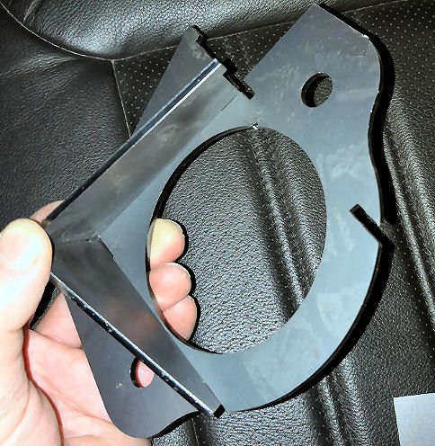

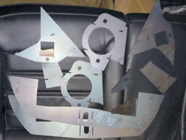

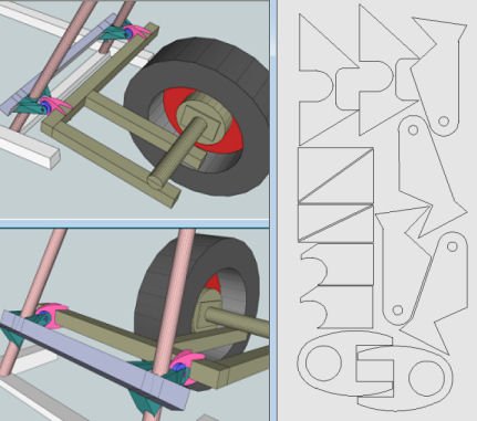

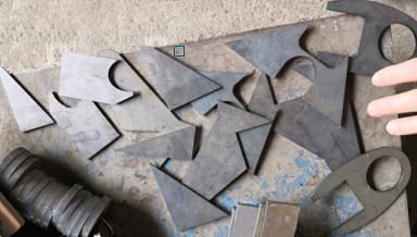

Per Mark BEX :

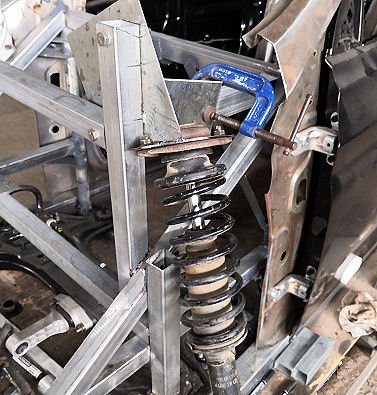

My strut top laser'ed parts weren't ready until late afternoon, but done none the less.
You can see how effective the tab and slots are for jig'less alignment, fit perfectly together for welding later.
My comment :
Mark's experience in designing and building are clear .... I'm not only enjoying following his build while my appreciation for his methodical approach is growing rapidly
My comment :
- 210512 001 the build 001.jpg (18.85 KiB) Viewed 5612 times

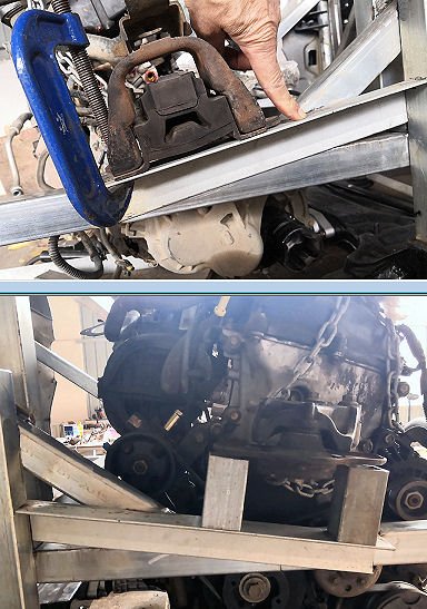

Per Mark BEX :
I was drawing up a fancy eng mount for the right hand side, the left seemed simple enough, arrived at the factory this morning, was staring at it, and thought "Why not just use some 2" angle iron?".
Seemed too simple, but gee, it was simple! triangulates and increases shear strength, I'm happy.
I like that left and right sides the same, with the right side requiring some simple box tube risers.
It will get me going for now ..

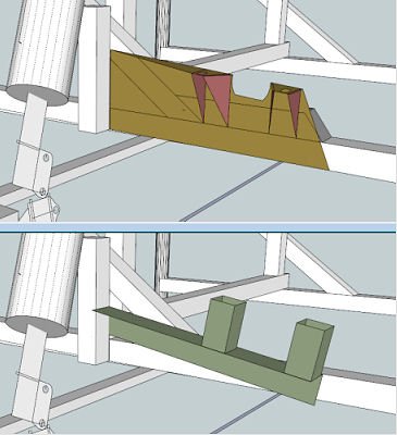

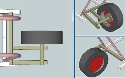

Per Mark BEX :
The brown part is what i had drawn up, flat sheet requiring laser cutting, then folding, then the 4 gussets welded in ....
..... and now the green is the angle iron with 2 short lengths of box tube welded on.
Night and day which one is faster and cheapest.
- 210514 001 the build 001.jpg (29.68 KiB) Viewed 5589 times
0 x

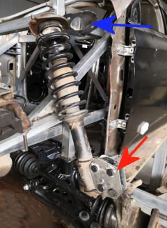

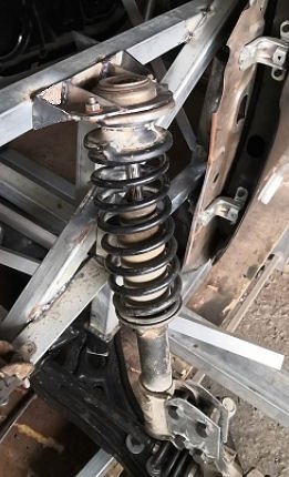

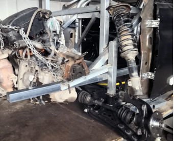

Per Mark BEX :

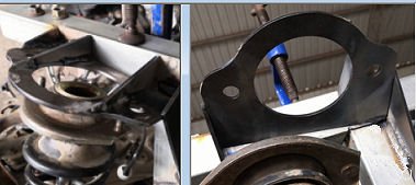

Today was about getting the new strut top mountings together, and you can see it's all much neater looking now up there, as per the CAD drawing ...
I put the CV shafts in and had to move the engine/gearbox 12mm/0.5" to the right, which was fine as I had already provided for that possibility.
- 210515 001 the build 001.jpg (18.95 KiB) Viewed 5572 times
- 210515 001 the build 002.jpg (35.83 KiB) Viewed 5572 times
- 210515 001 the build 003.jpg (27.84 KiB) Viewed 5572 times

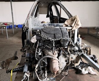

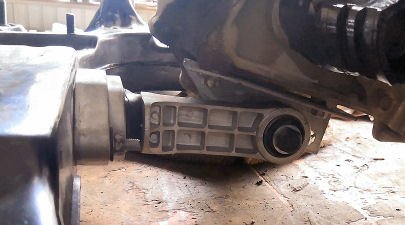

Per Mark Bex :
A minor milestone, first chance to test the suspension with the engine mounted, after I made a temporary dogbone mount bracket underneath t size it, to design a proper one.
Here's the video ...
https://www.youtube.com/watch?v=BNM2WJ3eXt8
- 210519 001 the build 001.jpg (21.08 KiB) Viewed 5550 times
- 210519 001 the build 002.jpg (31.85 KiB) Viewed 5550 times
0 x

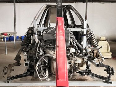

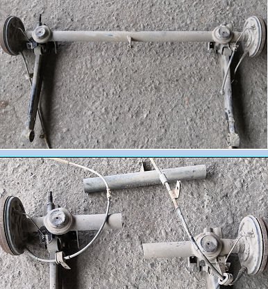

Per Mark Bex :

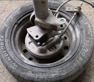

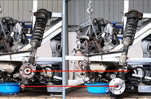

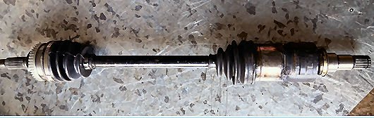

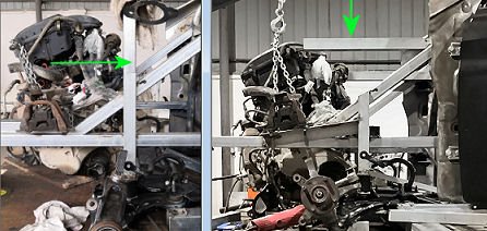

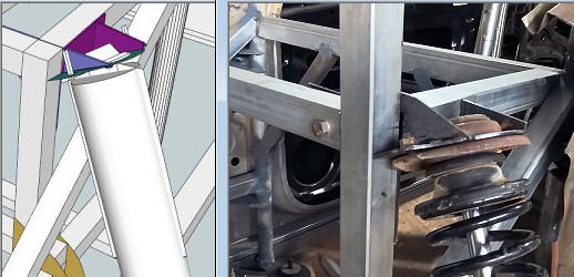

Things went good today, and I had a few good win as well!
I managed to sort out the new steering knuckles that required different lower ball joints that fitted into the same 2 holes in the lower control arm that was my first win.
The new steering knuckles required nothing but for the ball joint hole to be enlarged (clamp type, not taper), that was easy enough.
As I predicted, there is some 4" difference now for me to play with the car's ride height, as you can see by the red line comparison. Note if the hubs are higher (left) then the car is lower. That was my second win.
see picture 1
I believe I will be able to tuck the struts further into the bodywork with this new setup, there's a 3rd win. They will not be mounted at the same place as in the picture.
But the BIG WIN, is these new hubs are about 25 mm wider at the wheel flange, that means without doing a thing, I have just increased the front track (the distance between the centers of the front wheels) a further 50mm/2", that's great!
I think I will now have closer to 1600mm/63" wide track now, rather than the 1550mm I estimated. A wider track is more stability, though I consider the Elio at 1700 as being too wide, you also have to drive the car around car parks, cities and other tight spaces with convenience.
There's still a bit involved now to make up more new strut mounts, but it's not exceptionally difficult.
I also tacked on a CV inner end to the left CV inner joint/shaft to extend it to test lengths.
see picture 2
see picture 1
see picture 2
- 210524 001 the build 001.jpg (51.4 KiB) Viewed 5520 times
- 210524 001 the build 002.jpg (31.89 KiB) Viewed 5520 times
0 x
