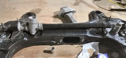

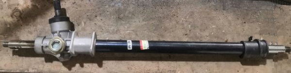

Per Mark BEX ....
So went through the parts racks today, and good news: The most suitable rack, that turns the right way this time (and the left way too!), is the same donor make and model as the front and rear spindles, hubs, brakes and suspension I am using, pleased about that ... I didn't consider it to begin with because I thought it turned the wrong way, DOH!
- 211231 001 rack 5 001.jpg (19.63 KiB) Viewed 1161 times
0 x

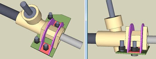

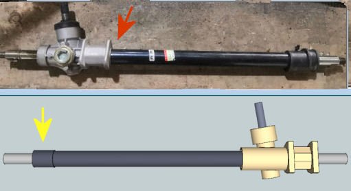

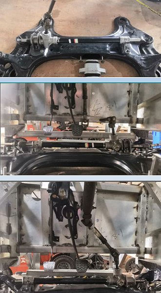

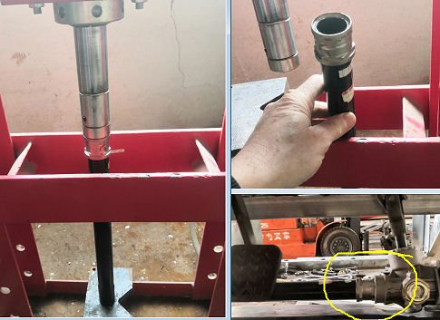

Re: Elio Type Vehicle Resurection --- AKA the BEX
Per Mark BEX ....
Ze steering rack is going to work very nicely as far as I can see so far.
Simply cut the steel tube off at the red arrow, move the pinion housing to the right hand side so the pinon shaft points to the center of the car, flip the steel tube over so it bush in the swaged section, yellow arrow, is at the left far end, and job done, just make up some mounts next.
The hardest part is stripping it completely down and washing it in gasoline, because it's all greased inside, and cutting the steel tube of course fills it up with grindings, sigh.
It takes time to sought out the steering geometry, it's not just a case of making a rack for it.
- 220101 rack 6 001.jpg (23.13 KiB) Viewed 1150 times
I asked Mark ....
for production, will you have to setup an area to make the necessary modifications or, once you need a stIeady supply, do you think the manufacture may take care of it for you ??
Mark's response ....
Either. It's easy enough for me to modify them if I have to do batches at a time. Great thing is there's no modifications required to the existing parts, other than the one cut (and the darn cleaning), or additional parts required. In future, anyone needs to replace the rack, can buy one 'off the shelf', slip the individual parts such as the main shaft, pinion and the bushings out the new rack, and just slip them into the old rack.
I doubt a company would want to make such small quantities, but at least they might supply them un-greased, which is where the largest chunk of time is lost (the cleaning). Maybe even disassembled, i.e. just the parts.
Question from a friend ....
Mark, would it be safe to say…. That working out the steering is one of the more unique and challenging aspects of this 3-wheeled, centered steered vehicle?
I've done all the geometry plenty of times before, been doing that since I was a teenager, setting up race cars etc, just takes a bit of time, the hardest part is an economically priced rack for center steering.
As I posted above, the few that are available, are either too expensive, or not good enough quality.
Steering, as in the total sum, is very important to get good feel and stability in a car, it's worth the effort put in, and only as good as the effort you do put in.

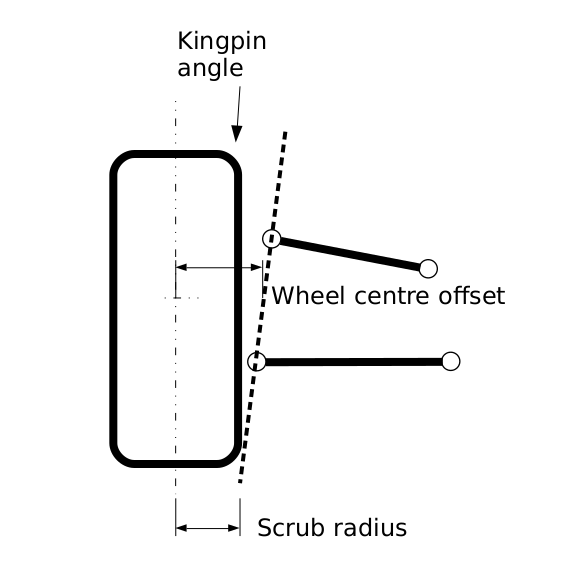

Per Mark BEX ....
I am still on setting up the steering, it was always going to be difficult, and it is proving to be so.
For example: Today's issue I came across is lower ball joint travel, or lack of it not allowing enough steering angle. The ball joint is not perpendicular to the KPI (king pin axis) and so swivels when the wheels are turned, rather than rotates, and it swivels too far ...
It's all surmountable, it just takes time, frustration and a few skinned knuckles. Luckily being Australian, I have all the swear words I need.

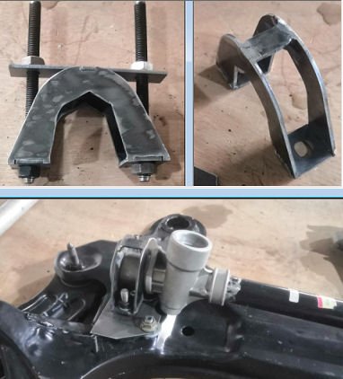

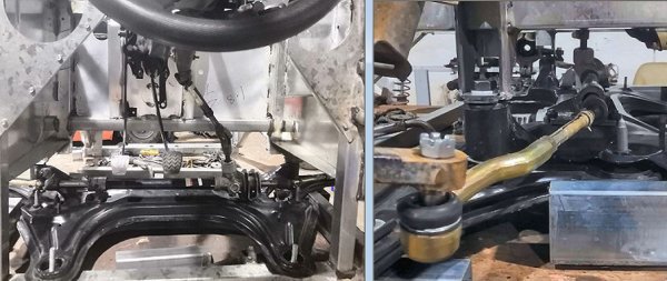

Per Mark BEX ....
modified steering rack in place
- 220108 001 steering 001.jpg (18.83 KiB) Viewed 1085 times

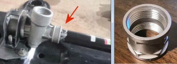

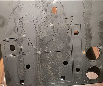

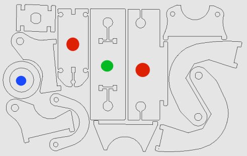

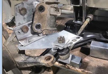

Per Mark BEX ....
the picture shows the correct angle of the steering pinion pointing towards the middle of the car, to facilitate the angle of the steering shaft from the steering wheel.
All be mounted by Monday so you'll see it then anyway as I designed the mountings, and gave the file to the laser shop today .
- 220108 002 rack 10 001.jpg (17.77 KiB) Viewed 1077 times
