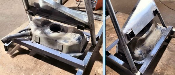

The fuel tank is mounted, but not.
I got a bit complicated with it, took a step back and realised how easy I could make it, cut out what I had made up, grabbed 2 lengths of angle iron, 4 holes and job done.
I will design and laser a more appropriate mounting system, but this is the foundation of it, i.e. KISS.

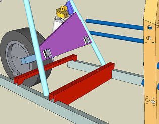

The tank mounts will also form the rear crossmember later, as seen in red here
- 211214 002 tank area 001.jpg (18.92 KiB) Viewed 1246 times
- 211214 001 Accent tank 1 001.jpg (42.41 KiB) Viewed 1253 times

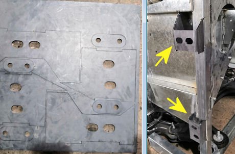

Simple but important step today, the new front door hinge chassis mounts.
Much better design, laser cut, simple 90 degree bends, and easier to assemble to the chassis than before, as they are self jigging.
I welded the hinge mounts in today, and then just continued welding the entire frame. Basically it has only been tack welded together in case mods needed to be made, but pretty happy with most of it, so weld I did
- 211217 001 hinge mnts 001.jpg (30.8 KiB) Viewed 1230 times

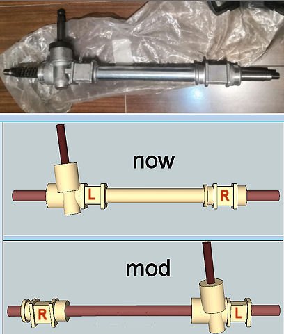

So decided and purchased a steering rack that I can modified without changing any of the original parts of it.
It comes down to simply cutting out the center tube, swapping the left and right ends over to opposite sides, and mounting them to a crossmember to retain the strength and retain alignment for the steering shaft.
This gets me the steering pinion shaft pointing towards the center of the car rather than away from it, which was the biggest issue for me to overcome. The only hassle I see a dust cover, maybe a length of bicycle tire tube will do the trick there.
Per Mark BEX ...
- 211229 001 rack 4001.jpg (36.65 KiB) Viewed 1115 times

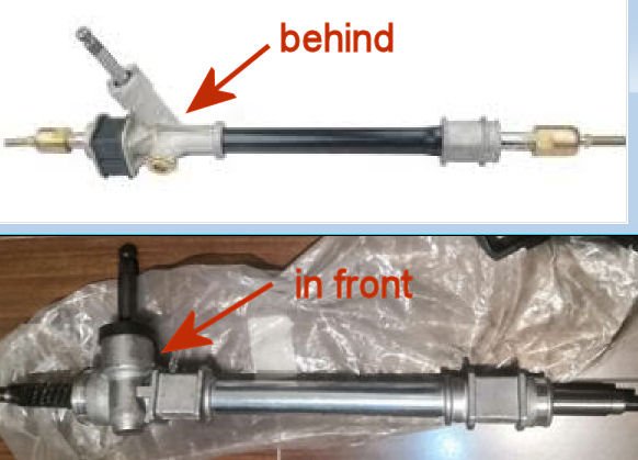

Oh oh, stupid me. The rack steers the wrong way, if you turned the steering wheel to the right, the car would go left! No problem, tomorrow morning go swap it over for a similar one that steers the right way ........ and the left way too!
The foundation as above doesn't change, the racks are near identical, just that one is for a forward steering arm spindle, and one is for a rear steering arm spindle.
You see the difference here, one has the pinion gear driving behind, one is in front, so the steering shaft goes in different directions.
Per Mark BEX ....
- 211230 001 rack 5 001.jpg (39.03 KiB) Viewed 1102 times
