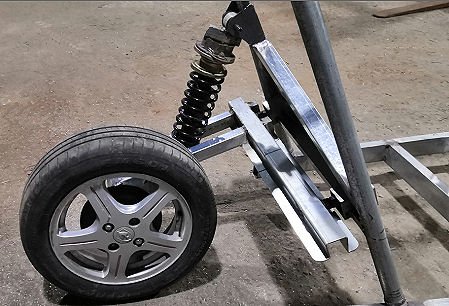

I thought up, designed, lasered and folded the new rear swingarm in a half day today, quite happy how it turned out too.
It's a simple 'tophat' fold, with the tube nuts and tube holes lasered out so it just all fits together in minutes, and gets welded.
Note it is quite wider than the roll bars, intentional to help stop it progressing forward into the cabin in a rear accident.
For those wondering, yes, it will be triangulated later.

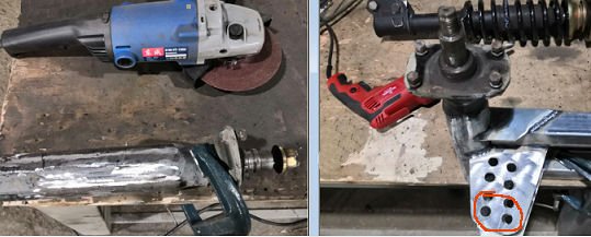

Finished the basic swingarm today, a few minor dimensional modifications are needed, but not to the basic design itself. I'll add a triangulation later, first make sure everything is going to clear everything.
One side is prettier than the other side, so I'll show that side ...
Was a bit of effort to clean the old brackets off the old rear suspension tube, I hope the manufacturer will sell me the tubes raw, if not, I will have to find an alternate tube to weld to the stub axle, just way too much time, noise and cost in cleaning the old brackets off.
I also mucked up something in the height, the 4 holes I lasered were way too low, circled in red below, so I had to hand drill 4 new ones, but that's cool, makes the brackets shorter, stronger and cheaper.
I am so used to laser cutting everything now, it was a shock to drill them by hand, along with grinding off the brackets, it was almost like work!

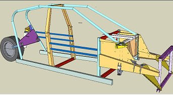

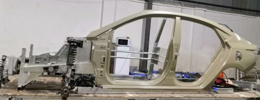

Well the new chassis is going to be put together step by step these days, the difference from before is I think this will be a production chassis completion, or one that will only require minor modifications from here on in. (picture 1)
The new design B Pillars are being laser cut, and folded tomorrow I hope. (picture 2)
Part of the reason is to incorporate side intrusion bars (picture above)
Also, I've also been experimenting with the rear seat setup, you Ladies can tell your husbands that they are going to be very comfortable back there ...

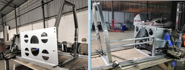

B Pillar was laser cut today, I took it to get folded, and started to look at the setup for issues.
You can see the jigging plate being used to line it up, using the door hinge holes, and I sat the side protection bars in looking for issues ... so far none.
As you will recall I had steel tube before, but this created alignment headaches, every bend can not be perfect, just a tenth of a degree difference in each of the total 10 bends in the 3 main roll hoops, and it ends up out of alignment very quickly.
The laser'ed parts are super accurate, and this makes the 2 main longitunal bars easier to be consistently placed accurately.

While quite happy with the B pillar design, as you can see with the red arrows, I can and will widen the top more to tuck it in closer to the bodywork. My fault, I played it too safe, worried about clearance issues, but pretty good overall first a first attempt, and you can see the lower half tucks in very nicely.
The panel with the yellow arrow, is an alignment jig, it doesn't stay there. It is the same alignment jig I use for the front firewall as well
You can see the side impact bars here, they are in their final position.
