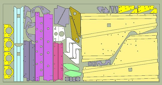

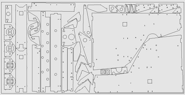

Per Mark BEX ---
the parts for the production front subframe, hopefully. There may be some minor mods required, but I'm hoping it works out as planned.
Now I have to translate it into a CNC file so I can get it all laser out, then to the fold shop.
Took me 3 days to get it right, the laser will cut it all out in under 5 minutes! I'm happy I managed to get this lot onto a standard 1000 x 2000 mm / 4 x 8' sheetmetal sheet too.
- 211102 001 more parts drawing 001.jpg (26.79 KiB) Viewed 1133 times
- 211102 001 more parts drawing 002.jpg (44.4 KiB) Viewed 1133 times
- 211102 001 more parts drawing 003.jpg (40.24 KiB) Viewed 1133 times

Re: Elio Type Vehicle Resurection --- AKA the BEX
Per Mark BEX ....

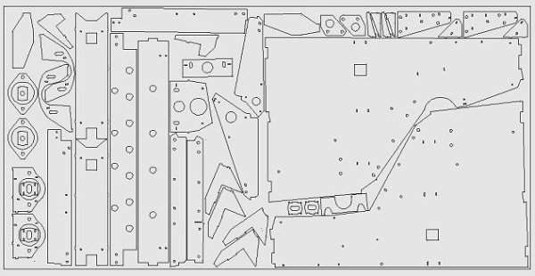

I spent about another 4 hours last night optimising and modifying a few things, it's really full now!
- 211103 001 optomized parts drawing 001.jpg (40.01 KiB) Viewed 1127 times

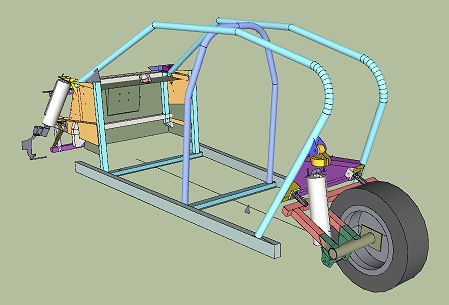

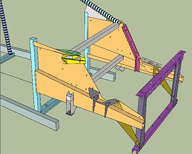

I am working my behind off sorting design elements closer to being production elements.
My laser wasn't done the last 2 days because they couldn't contact me to tell me they didn't have the thickness of metal sheet I requested, I didn't realise they didn't know how to contact me, so they were staying back tonight to cut my now 3 jobs, as I delivered 2 more to them this afternoon ... expecting to pick up Wednesday's job lot!
Promised me tomorrow morning to pick up. Hope the bending shop has time in the afternoon for me.
Now into the rear swinging arm and associated components, chassis mounts, swingarm bushes, new designed swingarm as well, but based on the prototype. Now is smaller, lighter and easier to build, with a moment of brilliance for the swingarm bush mountings that even surprised myself.

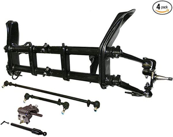

Per Mark BEX ...

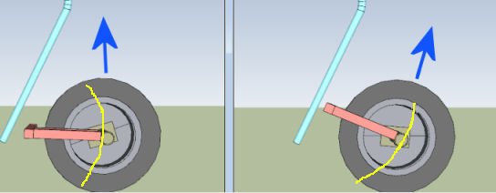

I was asked in the FB group why the rear swingarm pivot was high, here is my answer to that:
Mind your own business, what, are you a policeman, you nosy person?
Oh wait, that was my initial thought of reply, but then I wrote this:
The swingarm pivot is high and always was going to be, including on the prototype for good reason.
Driving a 3 wheeler on older roads has a distinct disadvantage, and it's been noted in some tests of them, Vanderhall, Morgans etc in that it's often difficult to miss a hole or a bump with one of the wheels, obviously the rear wheel being a big offender. Normal cars you might just drive the wheels either side of the hole. So one complaint has been hitting those holes or bumps.
I can't change that, but I can make the ride more comfortable by allowing the rear wheel to move backwards as it rolls over the bump. See Blue arrows and yellow arcs.
This also has a small effect of offering a 'rising rate' suspension, one that can be softer early in the travel, but increasing gets firmer so less chance of bottoming out. That also helps when you start putting weight in the rear of the car too, passenger, bags, dead bodies, illegally clubbed baby seals etc..
Anyone who has driven an older VW Beetle, or been involved in Off Road Racing, where the VW front ends ruled for many decades, it's the same, the VW front end moves in a similar rearward arc. You can see clearly on a Bug's front end the downward angle of the control arms ..
Another advantage is that it allows the fuel tank to be there under the pivots, the ideal place in the car for the tank.
- 211105 002 swing arm angle 001.jpg (15.89 KiB) Viewed 1089 times
- 211106 006 VW suspension 001.jpg (34.95 KiB) Viewed 1089 times
0 x

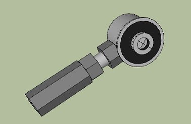

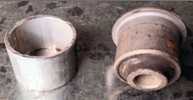

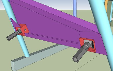

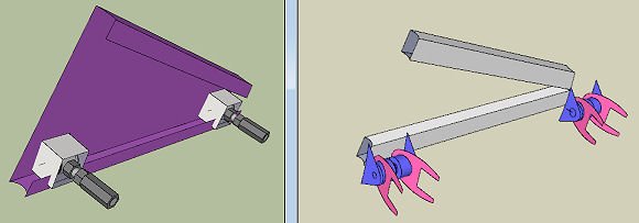

I asked Mark the following question :
in this area, my light bulb isn't just dim, its not even turned on .... in looking back, I can see there is a difference in design ..... I'd appreciate hearing about the advantages of the new design
Answer Per Mark BEX ....
It's a long story that goes back before this project, to my quest to find easy to produce, universal mounting bushes for swingarms, control arms etc.
I spent a lot of time going through parts shops, bush suppliers etc and finally found a common GM suspension bush, Chev Colorado in the USA, that is an ideal light press fit into a standard size water pipe. You can buy both anywhere in the world, and you don't have to go to a machine shop.
So I made up a couple of rod ends with everything hardware store bought, water pipe, booker rod, nuts and tube nuts, to make these simple rod ends, by simply welding a nut to the pipe, check ... (left my phone at the factory so no pictures)
... then I wondered around the factory considering what design for the chassis mounting brackets, and then the lighbulb struck as I walked past a length of 60mm/2.36" box tube, holy smoke, a perfect fit! Enough side to side movement for production tolerances, easy clearance for angles of travel, and a simple case of lasering square holes into the rear roll cage crossmember and weld them in place, just wonderful! No individual brackets to handle and line up, neat looking, box tube seen in the purple crossmember here ...
Compare new to old, oh and I forgot to mention that the new setup is adjustable, the old one wasn't, relying only on accurate jigging. the old style had sqyuare tubes that needed to be 'fishmouthed' by hand to suit where they met the round tubing, the folded sheet is simply laser cut to shape. You can see the fishmouth on the left lower corner of the purple sheet.
Some days are better than others
- 211105 003 old swing arm bushing 001.jpg (16.03 KiB) Viewed 1089 times
- 211105 004 new swing arm bushing 001.jpg (9.38 KiB) Viewed 1089 times
- 211105 005 chasssis mounting bracket 001.jpg (20.87 KiB) Viewed 1089 times
- 211105 065 new vs old chasssis mounting bracket 002.jpg (17.88 KiB) Viewed 1089 times
0 x

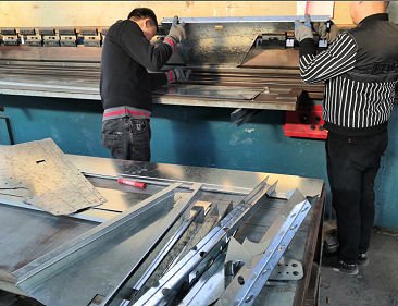

Per Mark BEX ....
The boys folding my parts up today ... excited to see how they fit up tomorrow.
- 211108 001 folding parts 001.jpg (32.46 KiB) Viewed 1073 times
0 x

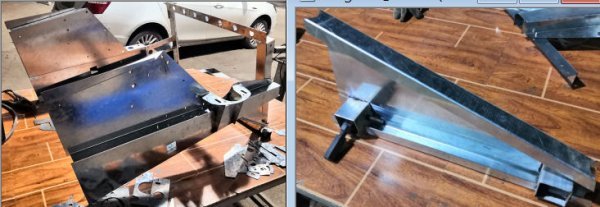

Playing around with the new front subframes, generally working out well, but I do have to make some changes, not because of the design, but because the metal folders had trouble with the left and right main sides due to the complicated bends, that were too tight in the machine.
The rear subframe has worked out just great though, was as simple and straightforward as I hoped for, can't wait to fit it up into the chassis the next day or 2. Pictured on the right with a rod end sticking out. It is just a sheet with a few folds, with 2 short lengths of box tube welded in, far less complicated and much faster to make than what I had.
