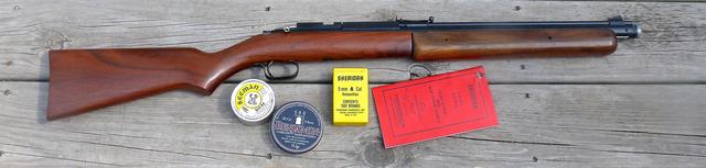

Re: Blue Streak furniture
That's a great vintage for a Sheridan. Have a couple from the 70s, including this mint Blue Streak from '72 that I got from the original owner. He was getting too old to comfortably pump it, so thought it needed good home. (It did.)Note that the wood on the pump arm is a different color than the buttstock. This was very common on all classic pump air rifles like this.
The first Benjamin pump I ever had was a nickel plated 397. The wood was so mismatched I contacted Crosman. I ended up driving there and they replaced the stock while I waited.
I like your idea of the light refinish NCG. Your Blue Streak looks great.
