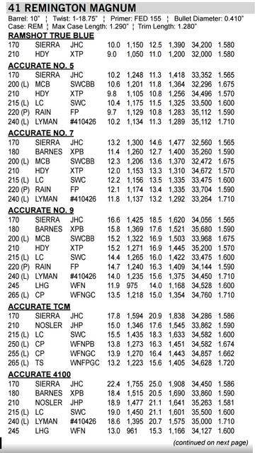

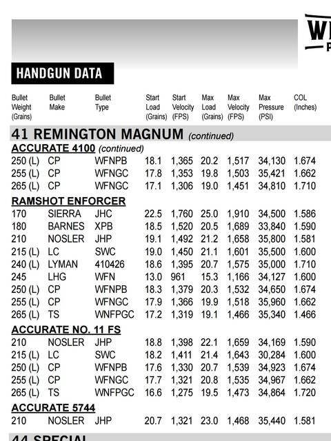

For those that don't like H110/W296... try Accurate 4100 or Ramshot Enforcer (both the same powder, with a different label, like 110 and 296).
I use it for high intensity loads in my Blackhawk where it gives just over 1,500 fps and great accuracy from the 6.5 inch barrel at a little under the max load recommended by the powder manufacturer... that is with 210 XTP bullets.
For plinker loads I use whatever I've got with some leftover powder in it.... Unique, Power Pistol, Titegroup, been burning up some Accurate #9 too.
