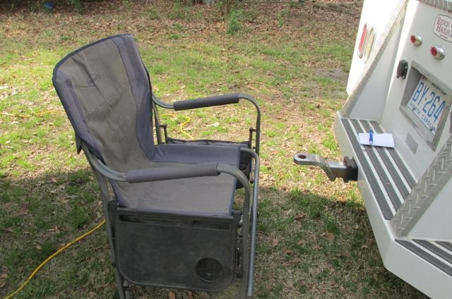

Post by JEBar » Mon Mar 30, 2020 5:19 pm

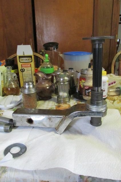

first generation shown below .... I already had the hitch .... so far, $15 spent on parts at Home Depot .... hardest par so far was using a Dremel type tool to route out the hole in the hitch so it was large enough to accommodate the 3/4" pipe .... tomorrow I hope to come up with some spacers .... still debating metal or wood plate

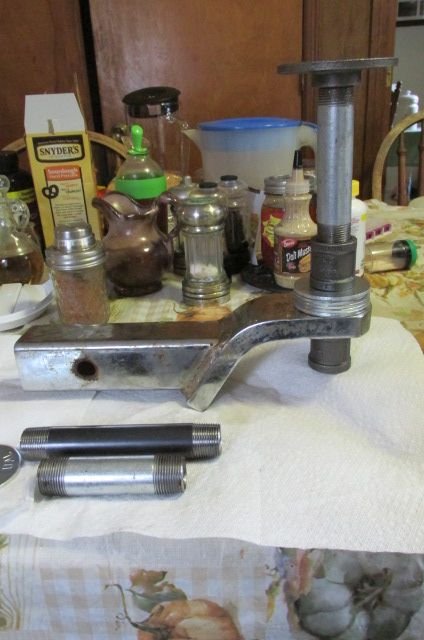

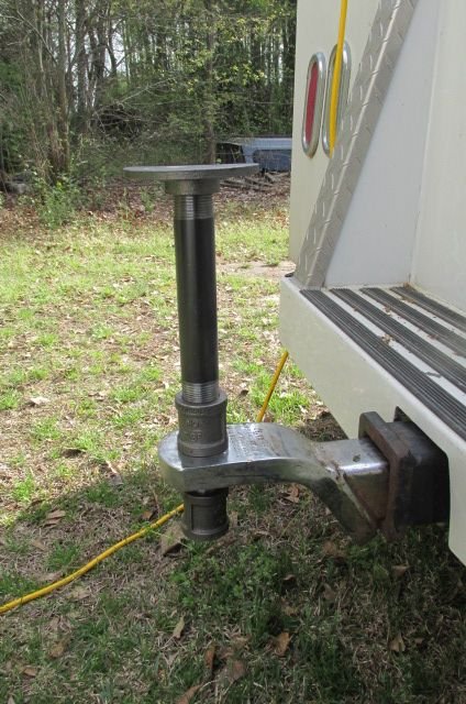

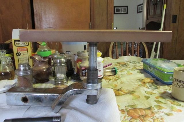

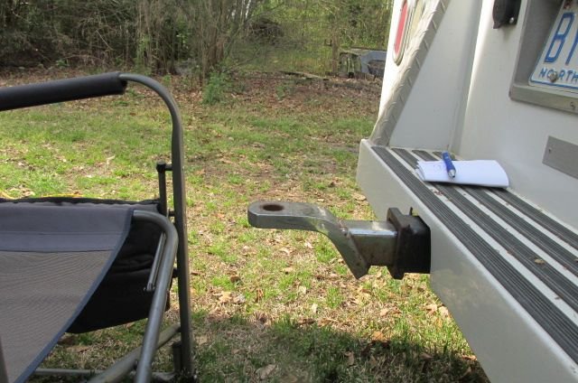

another $14 spent on pipes and spacers .... now have 4", 5", & 6" riser pipes .... the board is one I have on hand .... hope it will work out, if not will find something else .... supposed to rain all day, don't anticipate being able to bolt it all together until tomorrow at the earliest .... we were pleasantry surprised to have the new press arrive a day early ....unsure exactly how we will bolt it to the board, may use wingnuts

Post by Mistered » Tue Mar 31, 2020 2:01 pm
Looks like it outta work but I think I would bolt it securely with standard nuts.
Hopefully the surface area of the base the wood will be mounted to is large enough to provide enough surface area to support the press!

understood on the surface area .... time will tell .... the only reason for wingnuts is to help speed up the setup and take down .... my hope is to stream line the process to where it requires the fewest possible tools
In this case I would consider some 'star' knob screws. Larger and greater surface area to grip them with to tighten them down.

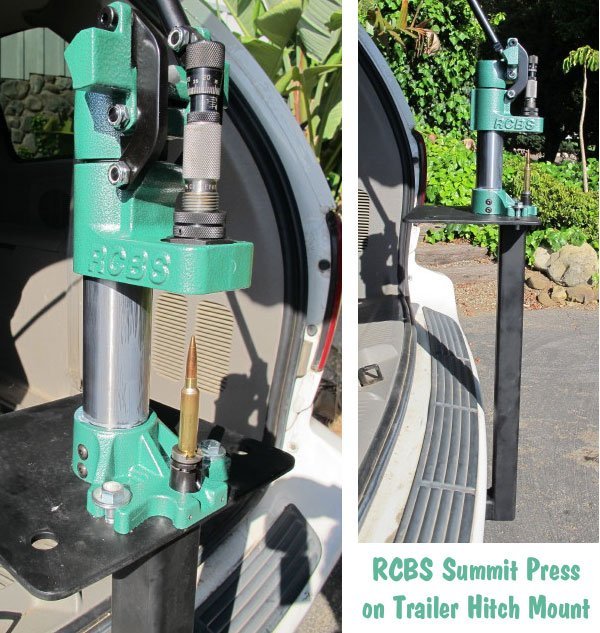

Re: Portable Reloading Press
Post by RanchRoper » Thu Apr 02, 2020 9:56 pm
This is what I have except my press is a turret one. Pretty simple and functional. Lee.
