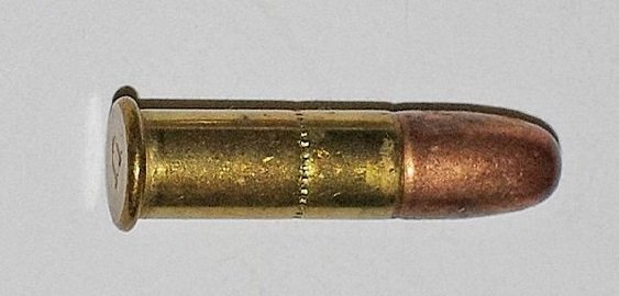

Reading many online forums the AR-7 has a reputation for being a jamomatic with varying degrees of reliability depending on who manufactured it. What if all the reliability issues are due to the wrong ammunition being used?
The 1899 Hague Convention prohibited the use of bullets which expand or flatten easily in the human body which banned soft-point bullets. Although the United States did not ratify this convention I have read that they choose to abide by it and as a result the Cartridge Caliber .22 Ball Long Rifle M24 was developed.
Cartridge Caliber .22 Ball Long Rifle M24 (Ref: TM-9-1305-200)
Cartridge. This cartridge is intended for use in caliber .22 long rifle survival weapons and is provided in Air Force survival kits. Its primary purpose is for hunting small game
Cartridge Length – 0.995 inch
Cartridge Case Length – 0.613 inch
Bullet – Gilding Metal Jacket with Lead-Antimony Slug 0.475 inch long.
Accuracy – extreme spread of all targets at 100 yards is not greater than 1.25 inches.
Complete Cartridge Weight – 53 grain
Cartridge Case Weight – 10 grain
Propellant Weight – 2.5 grain
Bullet Weight
- Complete 40.5 grain
- Jacket 6.5 grain
- Slug 34 grain.
I find it interesting to note that in the same manual the Cartridge Caliber .22 Ball Long Rifle Western Super Match Mk III accuracy was 2.5 inches at 100 yds.
The Cartridge Caliber .22 Ball Long Rifle M24 had a velocity of 1185 fps 15 feet from the muzzle. My AR-7s run very reliably with copper plated bullets such as CCI Mini Mags which are listed at 1255 fps but are less than reliable with ammunition such as CCI Standard Velocity lead round nose at 1070 fps.
I wonder how well my rifle would run if I had .22 LR full metal jacket?

- M24 22 FMJ.jpg (25.48 KiB) Viewed 26892 times
